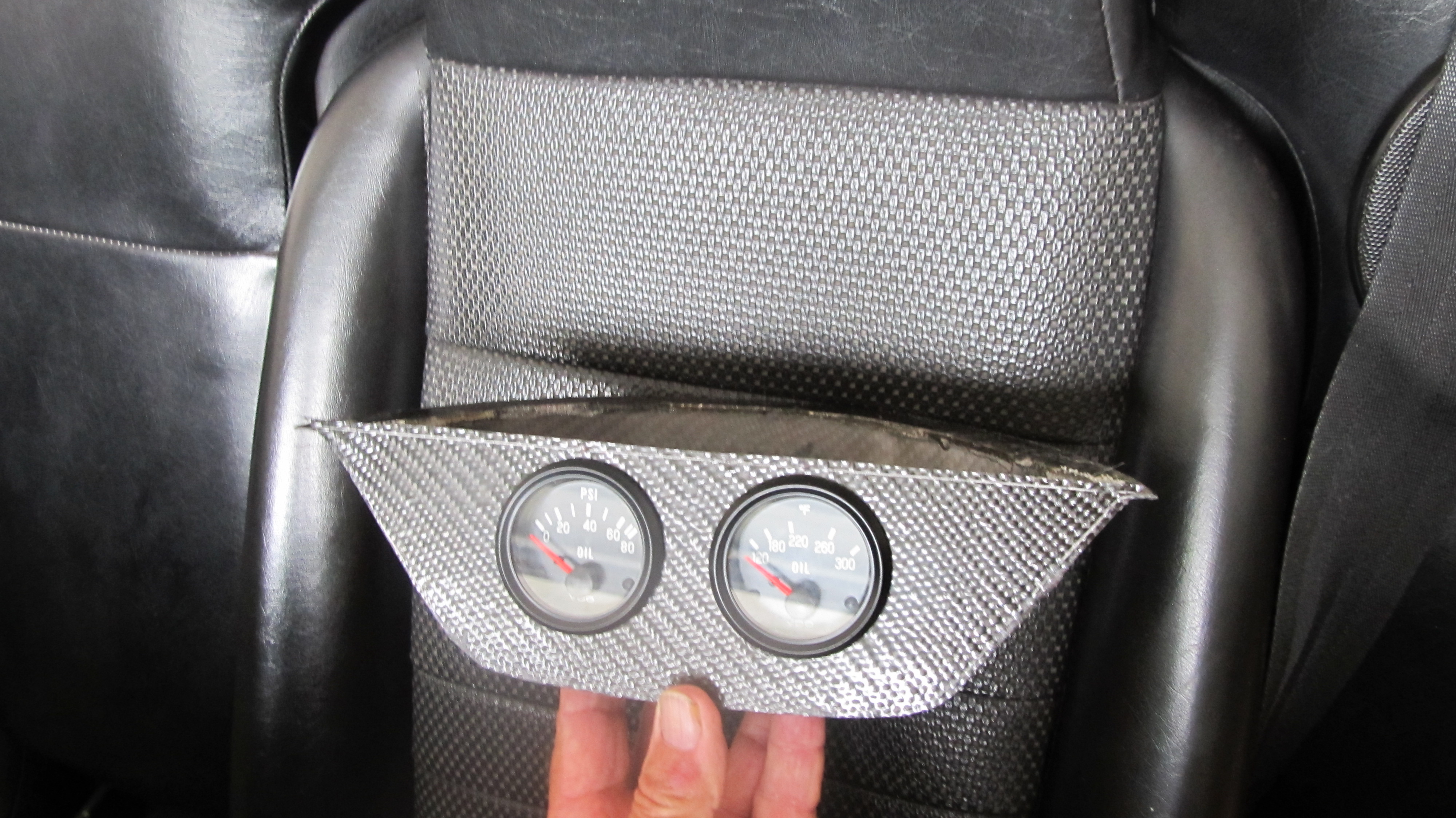

Attached Image While laying up a carbon part I noticed that the twill fabric resembled the 914 upholstery. I needed a couple more gauges so I made this to hang below the dash.

fiberglass1inc   While laying up a carbon part I noticed that the...   Feb 11 2016, 05:06 PM
fiberglass1inc   Installed under dash   Feb 11 2016, 05:44 PM
