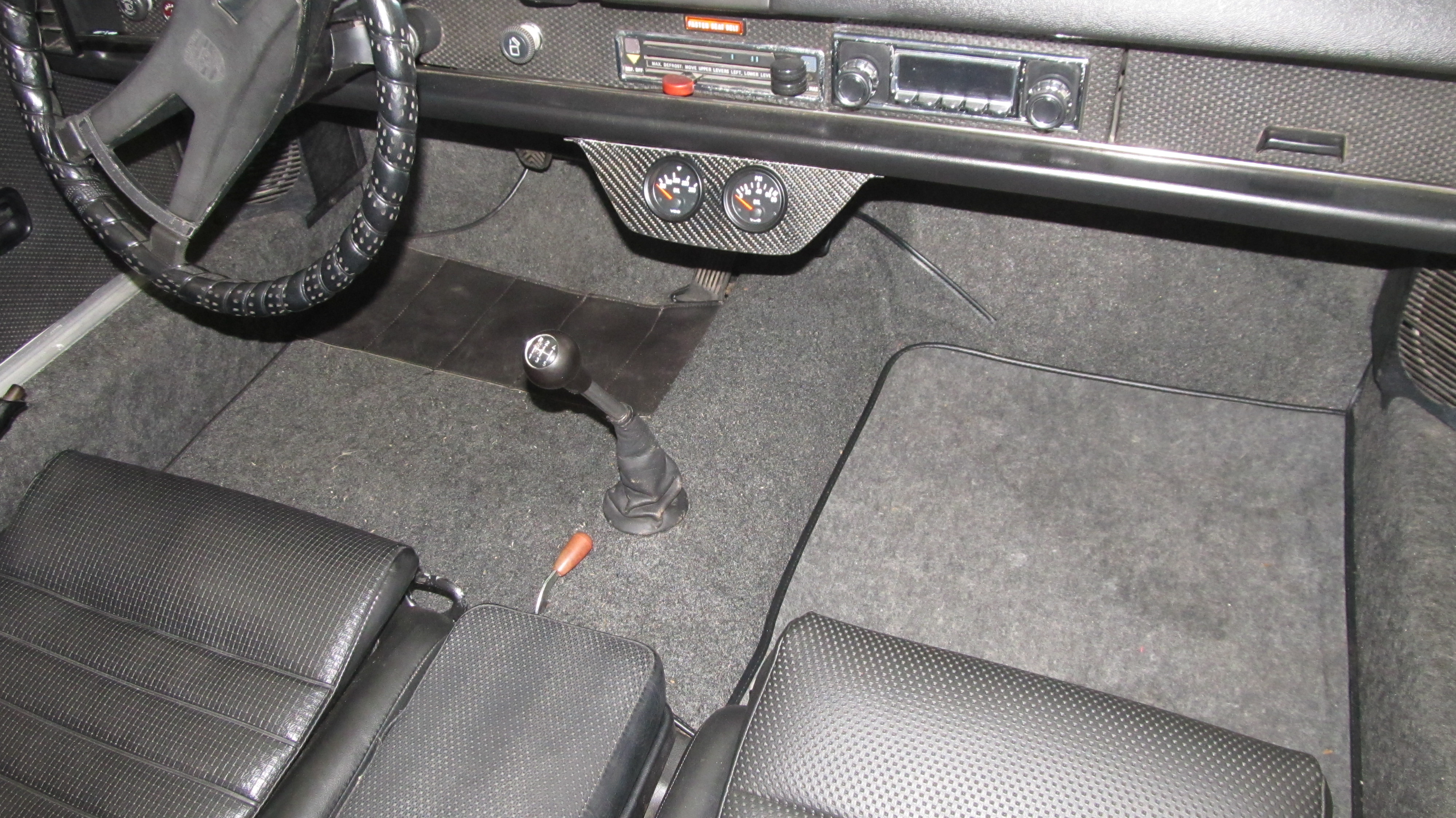

fiberglass1inc
post Feb 11 2016, 05:44 PM
Posts: 17
Joined: 13-April 14
From: WPB Florida
Member No.: 17,248
Installed under dashAttached Image

fiberglass1inc   While laying up a carbon part I noticed that the...   Feb 11 2016, 05:06 PM
fiberglass1inc   Installed under dash   Feb 11 2016, 05:44 PM
