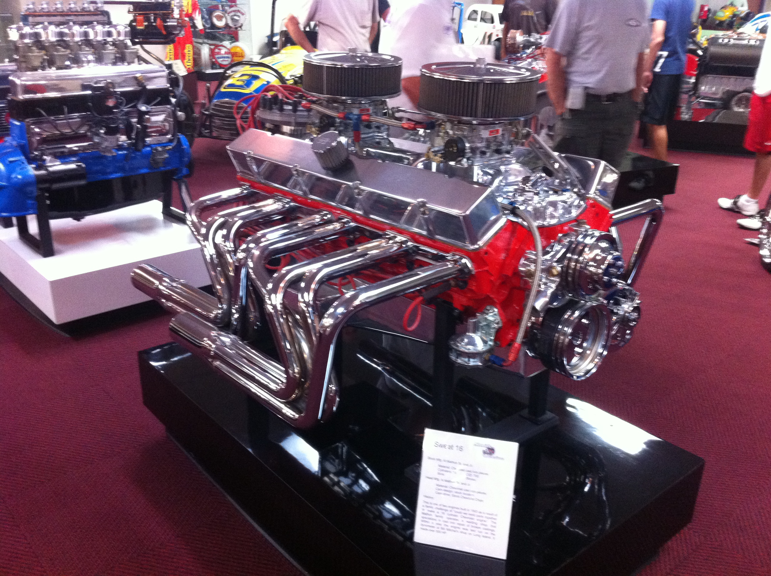

Got just the motor to replace yours.
May require some metal fab.
Nothing like doubling up (IMG:style_emoticons/default/biggrin.gif)
