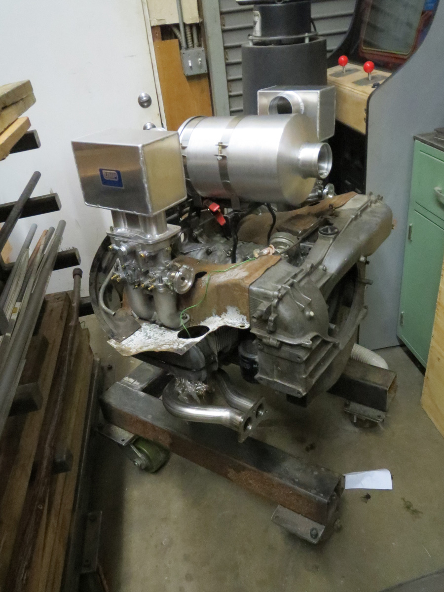

Mario, of the dub shop (thedubshop.net) fabed up an awesome intake for the 914. It looks great and now I can even hear the Tangerine Racing exhaust over the itb's. (IMG:style_emoticons/default/piratenanner.gif)

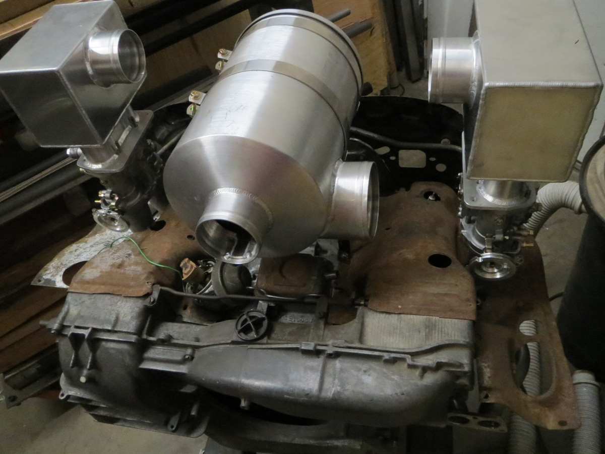

I've been working on something similar, I got the blowthrough boxes and the filter from pacific customs, ump brand. I just got the tubing to connect it all from spectre performance. My goal is to reduce intake drone.
I'm planning on using a scat linkage probably, as the tangerine pulley linkage pictured isn't going to fit with shorter csp manifolds which are port matched.

QUOTE(nathansnathan @ Feb 12 2016, 07:38 PM) *
My recent revisions might provide the cable clearance to the tin & plug wires that you need.
