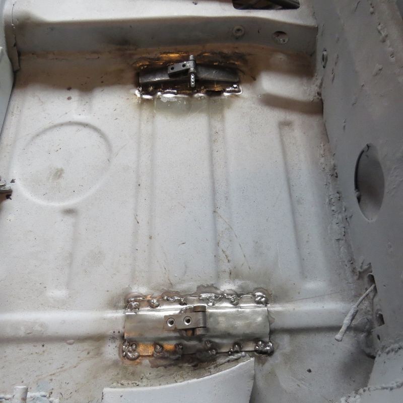

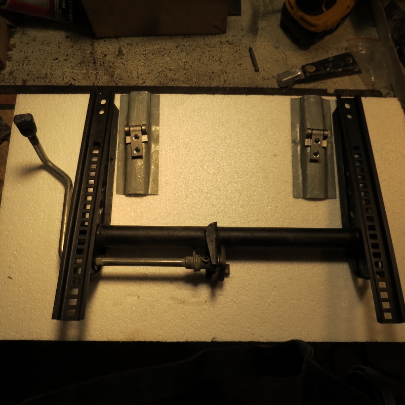

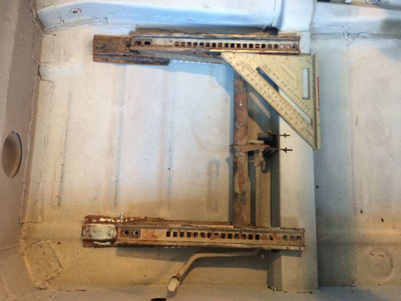

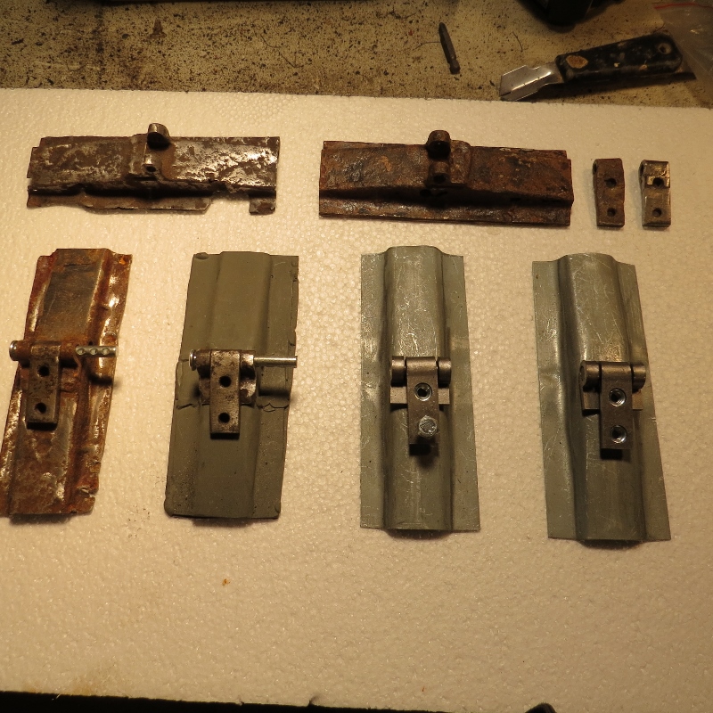

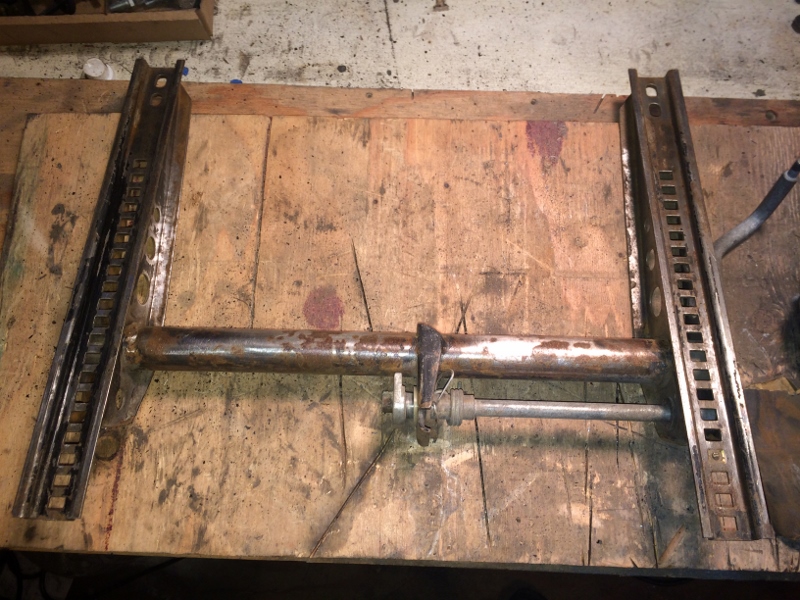

After much deliberation, I have decided to go stock with the seats and upgade the passenger seat from the '71 fixed to an adjustable. My floorpans were rusted badly and I could not save the seat hinges, so thanks to mrihop I was able to get some newer parts, seat brackets, risers and hinges. Still, I had to break down and buy a couple newer hinges and risers. It's just not worth trying to save them out if they are rusted. There's a great video on how to align the hinges and weld everything together from restorationdesign.com
How to mount the seat hinges in a 914
(IMG:http://www.914world.com/bbs2/uploads_offsite/i1301.photobucket.com-17072-1455404356.1.jpg)
(IMG:http://www.914world.com/bbs2/uploads_offsite/i1301.photobucket.com-17072-1455404356.2.jpg)
(IMG:http://www.914world.com/bbs2/uploads_offsite/i1301.photobucket.com-17072-1455404356.3.jpg)
(IMG:http://www.914world.com/bbs2/uploads_offsite/i1301.photobucket.com-17072-1455404357.4.jpg)
(IMG:http://www.914world.com/bbs2/uploads_offsite/i1301.photobucket.com-17072-1455404357.5.jpg)

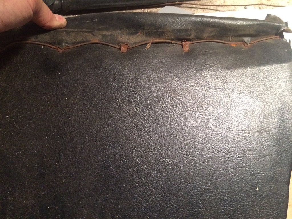

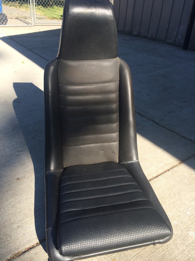

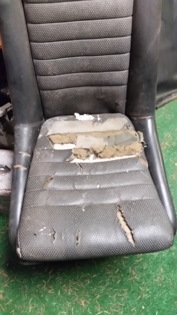

I decided to reupholster my seats at least partly. I got tow seats on 914world for $75 bucks each and cushion covers for another $70 bucks each. Went down to Joe (Women's fabric shop) and bought a yard of vinyl for $20 and some glue. Here's some before and after shots. These are not concourse seats but I think they look pretty good and they're certainly a lot cheaper than new.
(IMG:http://www.914world.com/bbs2/uploads_offsite/i1301.photobucket.com-17072-1466991636.1.jpg)
Before
(IMG:http://www.914world.com/bbs2/uploads_offsite/i1301.photobucket.com-17072-1466990990.2.jpeg)
After

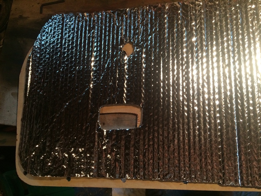

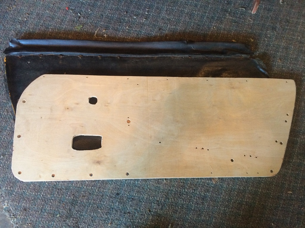

My door panels were not serviceable, so I decided to redo the inside panel and re-upholster the vinyl. I used thin plywood, about 1/4 inch birch. The old panel was used as a template which worked great. I used bubble insulation for padding and noise reduction. The most important part is to use a good glue. In my case, I used weather strip adhesive- GREAT STUFF!.
The wood cutout from the original template:
(IMG:http://www.914world.com/bbs2/uploads_offsite/i1301.photobucket.com-17072-1471582246.1.jpg)
Funky backing:
(IMG:http://www.914world.com/bbs2/uploads_offsite/i1301.photobucket.com-17072-1471582246.2.jpg)
Bubble Wrap padding:
(IMG:http://www.914world.com/bbs2/uploads_offsite/i1301.photobucket.com-17072-1471582246.3.jpg)
