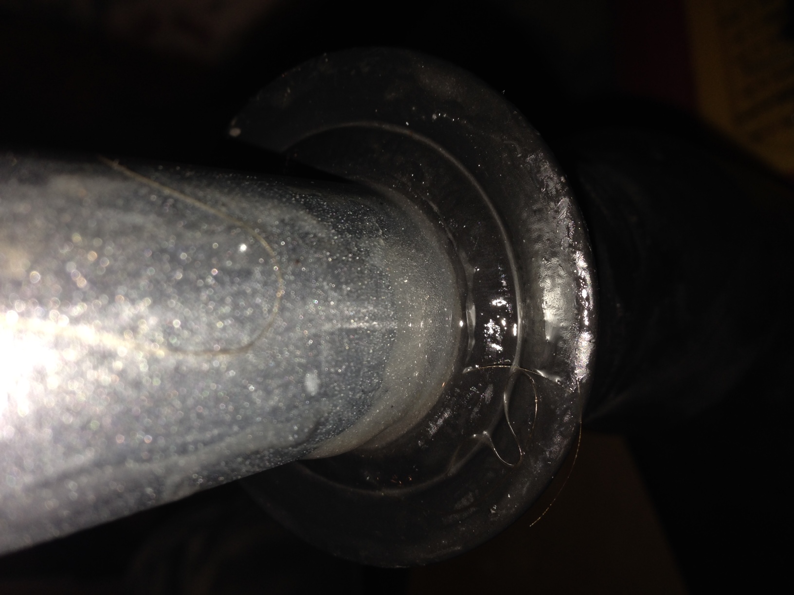

OK, I am staring to think that there may be a flaw in the design / manufacture of these bushings or shaft. That or the provided install instructions are off. Just does not seem like it should be this hard using the proper tools.
Trailing arm number 2. Bushing area is now clean metal, even honed to a nice smooth surface. Same danged thing as I go to press in the pivot shaft. Even with tons of hand soap the pivot shaft winds up pulling the bushing into the trailing arm as shown here. Pivot shaft is on left , you can see the bushing being pulled into the trailing arm. I am thinking that the reason it fit in last time is that after multiple attempts that it wore enough of the inner bushing away to allow it to fit.
