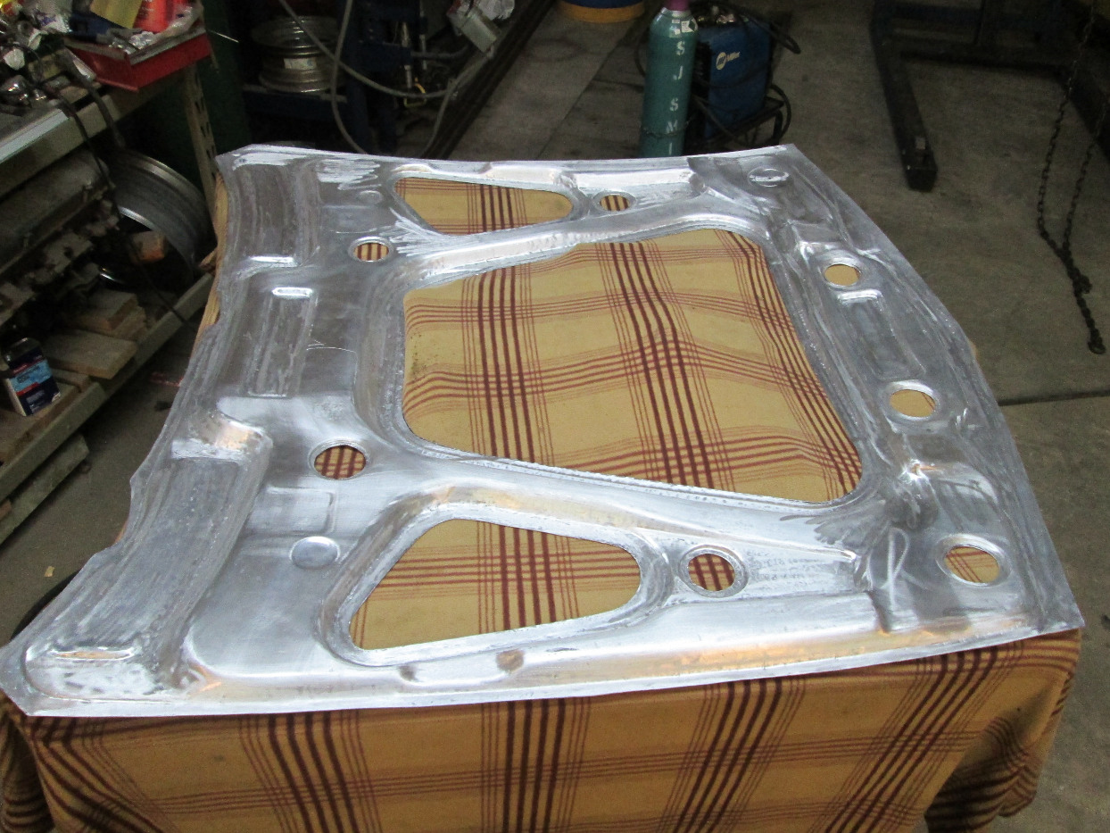

https://www.gimp.org/
Some people can use a camera properly,this was a 'front' pix.
The pix was from the most immaculate 914-6-Turbo you will ever see.
'iamchappy' here on board.
Drawing is from 2008,when I first sampled the pix.
The auto sector had taken a dump,and some 20k people had been laid off.
Had some spare time and tried sketching a few things.
The methodology today is a little different than days of old.
https://www.youtube.com/watch?v=mbrq2fDN8bA
This panel is the traditional aluminum hand beaten method.
Light,beautiful,difficult.
A panel man from Illinois made it.
http://imgur.com/gallery/lnluh
