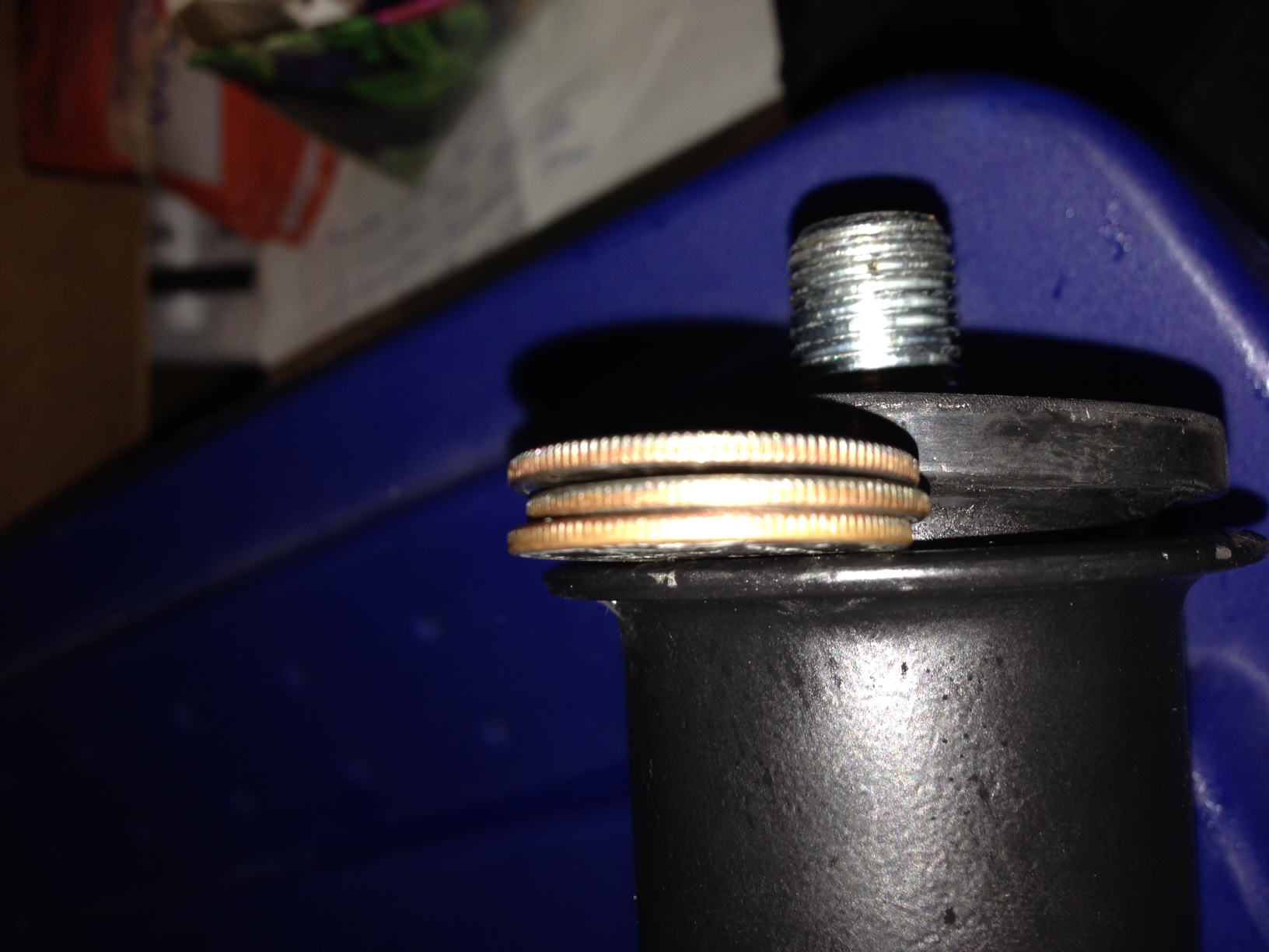

OK, finally starting to put things back together. New bearings went into freshly powder coated trailing arms this evening.
I then went to install the new rubber bushings and pivot shaft from Elephant Racing and here is where I am running into problems even with their tool set.
Per their instructions you set the bushings in the trailing arm and then using a pipe clamp and the provided tools, you soap the heck out of the parts and insert the pivot shaft through the one bushing and push it all the way through with pressure from the pipe clamp.
Works well for the first few inches until the pivot shaft starts pulling the bushing down through the trailing arm. Getting everything back out was not fun, could only do it using my press.
In watching a redneck video His description) the guy seems to put the pivot shaft on first and then push the bushings in at both ends. First seems to go easy, second he helps along with a hammer and a tool to fit over the bushing.
Anyway, suggestions on best approach welcomed. I really figured that by paying a premium for the set with the tools that this would be simple. Arrrgh.

I did not want to deal with it anymore last night but did give it a shot this morning. Victory finally seemed within my grasp as the pivot shaft was indeed going in without pulling the bushing into the trailing arm.
So, as if irony is taunting me, this time the bushing is not seated against the arm. As you can see, there is a gap which I can fit 2-3 quarters into. I suspect this would make fitting the arm back onto the car difficult to impossible.
I tried pressing the bushing in the rest of the way using the tool on one side and a similar sized socket on the other. Between the tight fit and the give of the rubber, it is not cooperating.
Unless someone has an idea, it looks like yet another round of press out the pivot shaft and try again.
