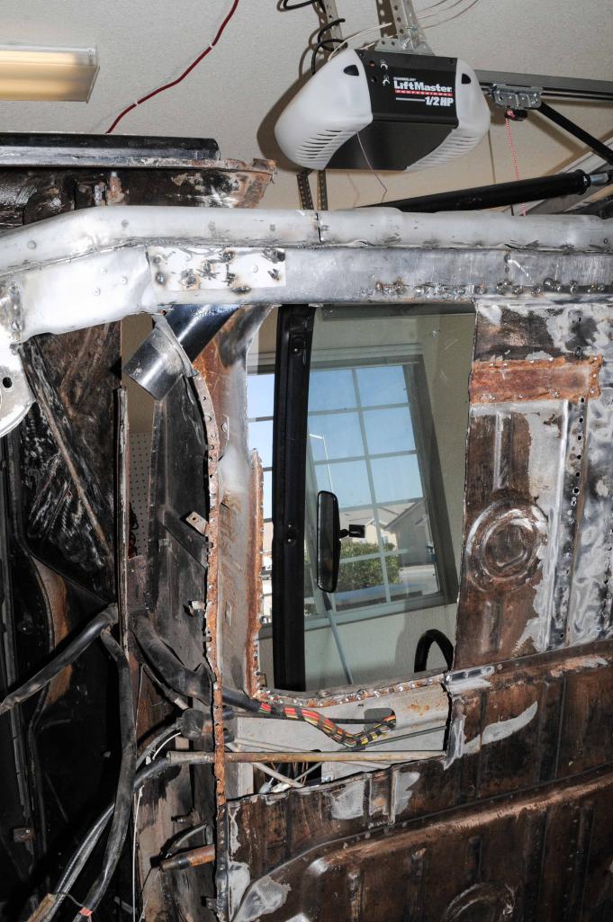

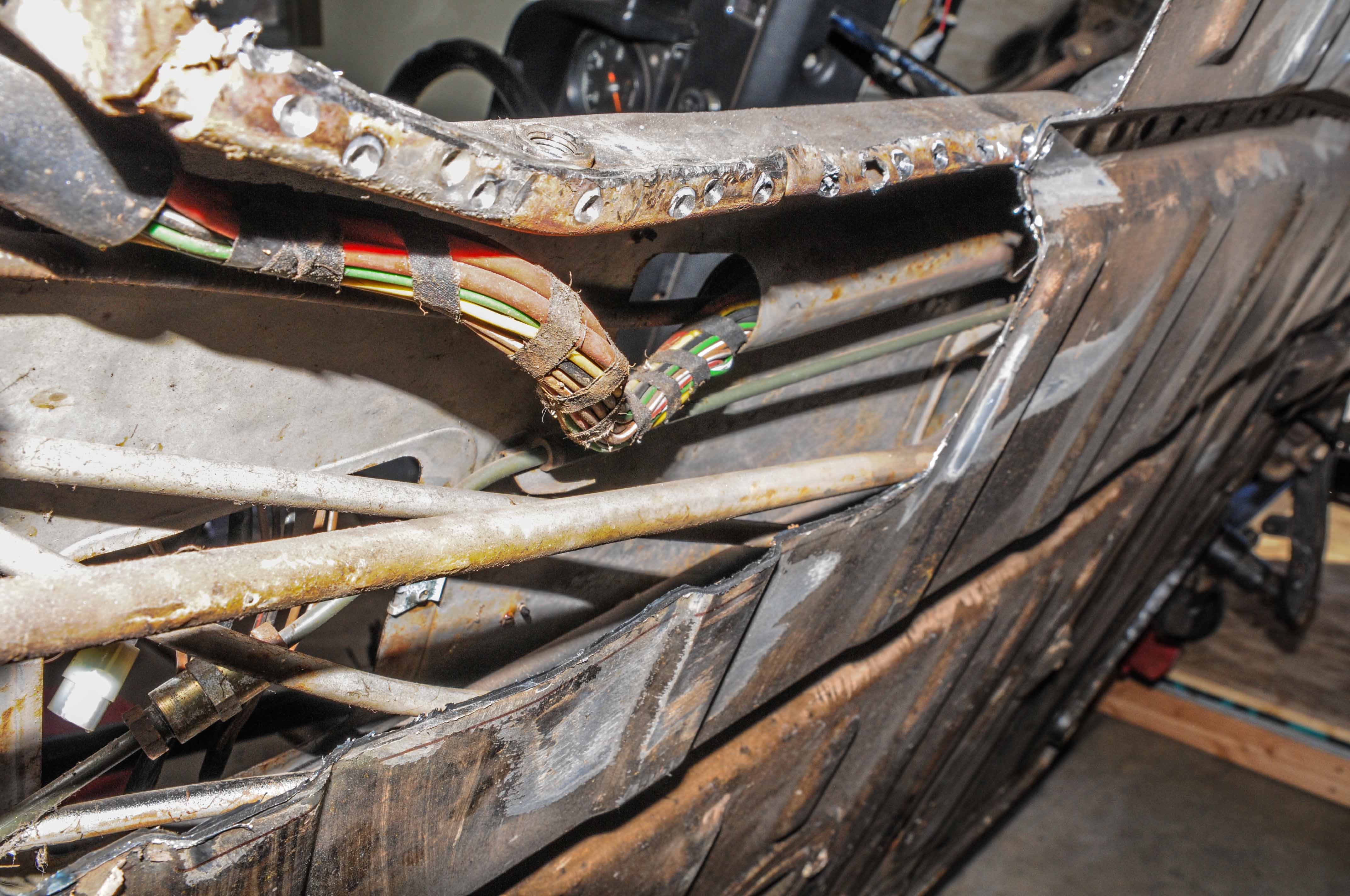

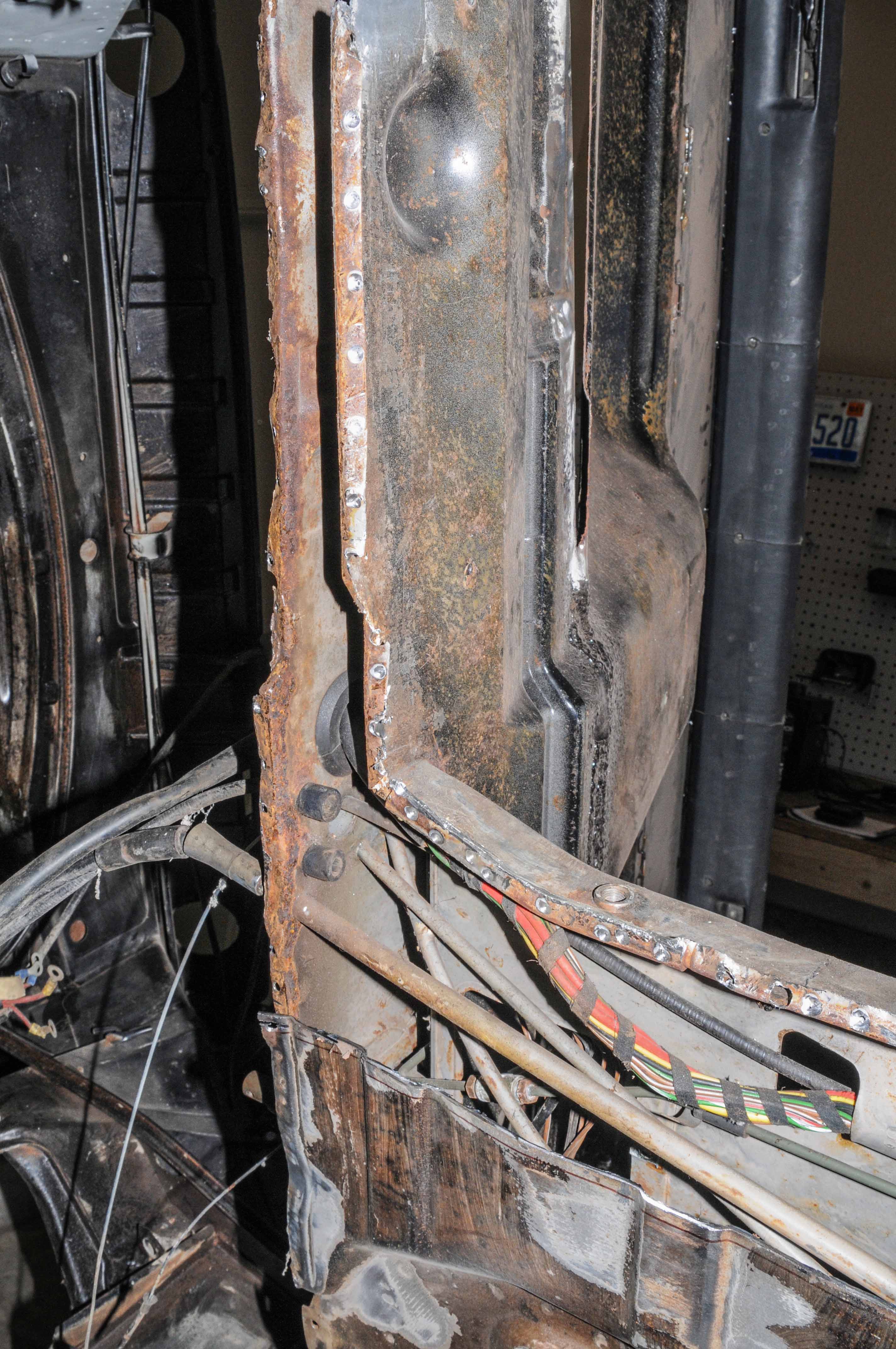

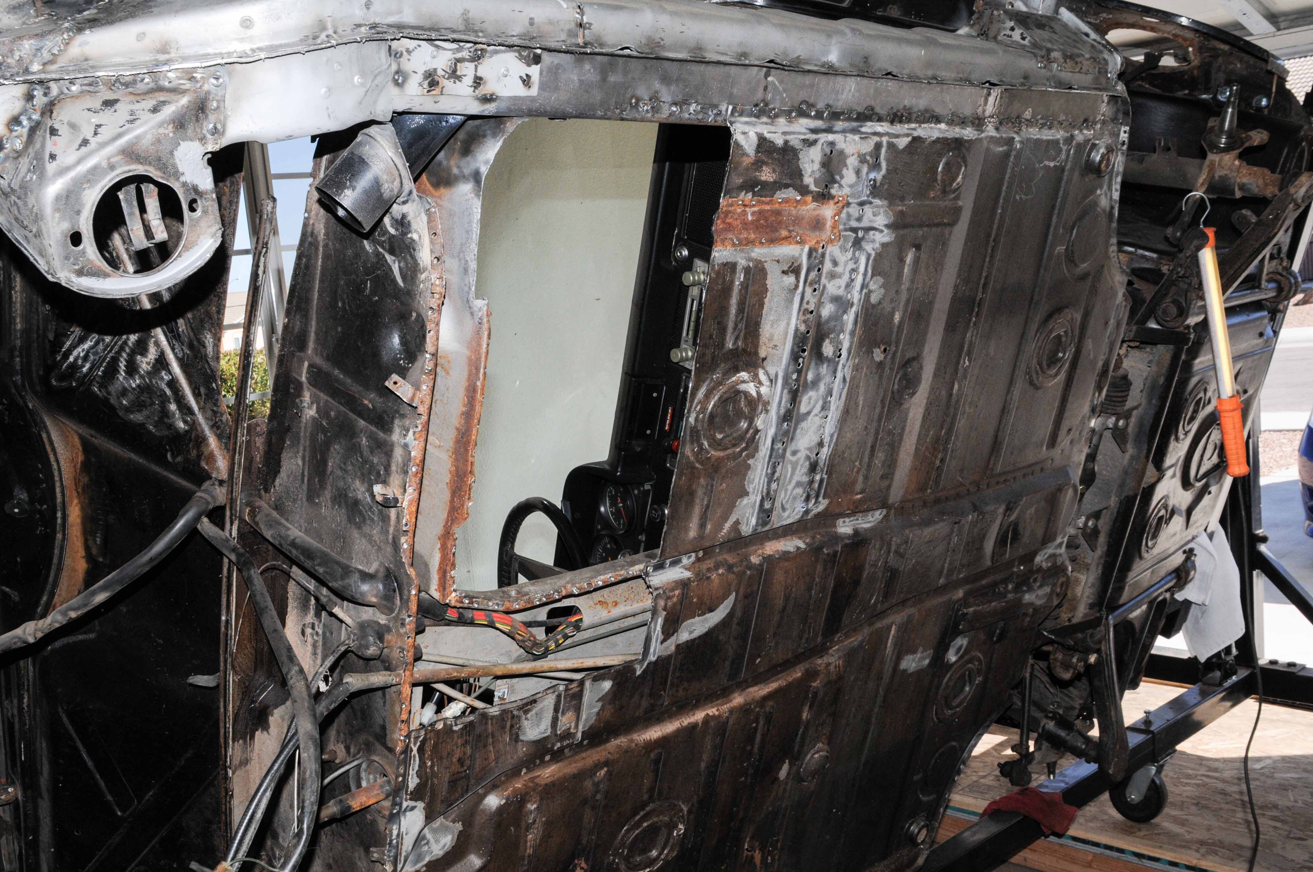

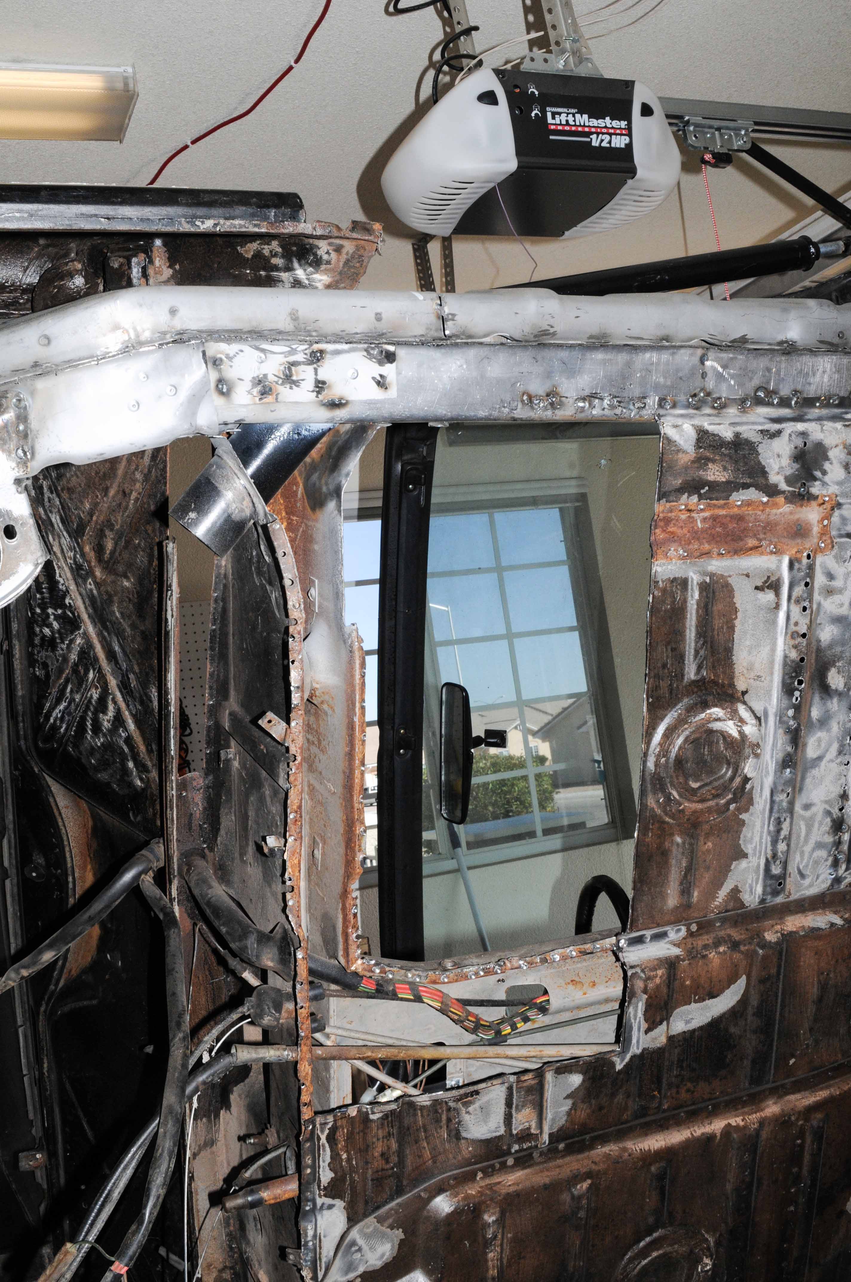

It was a long weekend but more in-laws were in town... but I still found some time to hit the workshop. It still wasn't the most productive time because I realized after it was too late to buy more that I was extremely low on welding gas. So I used my little bit of gas to weld the little piece on the long to flush it up, and the little piece on the front engine shelf. Then I got the floor cut out and all sized up to receive the new panel from RD, cleaned up the pictured rust and did some other random cleaning up around the car. This made days 2, 3, and 4 that I actually got to work on the car in 2016 since illness and an eye injury sidelined me... But the best 914 news of the year was finding that the inside of the tunnel was clean and 99% clear of rust!
Funniest moment was that the only thing I screwed up when cutting were both of the old fuel lines, which were rotted and needed replaced anyways.
