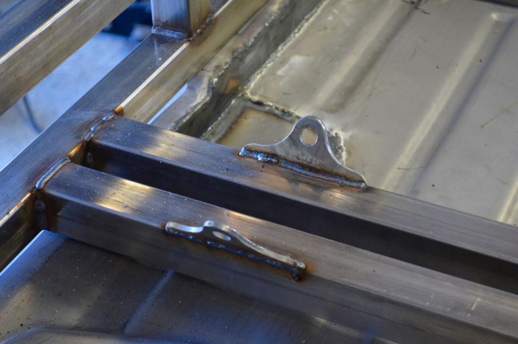

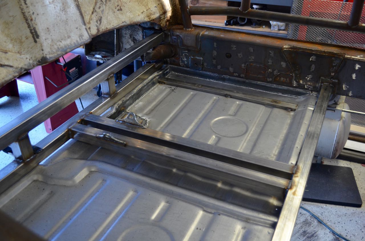

• Finished welding up the floorpan drop
• Fab'd and welded in the seat rails where the sliders will attach.
• Welded in the floorpan cross bracing and center tunnel
• Welded in seatbelt attachment points on center tunnel and chassis

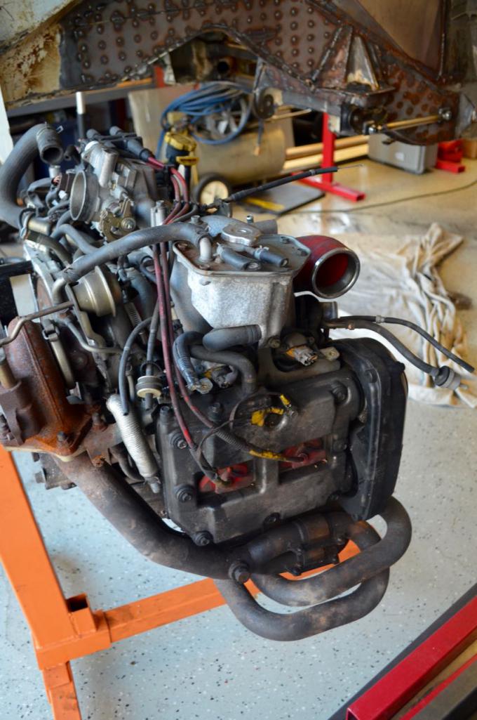

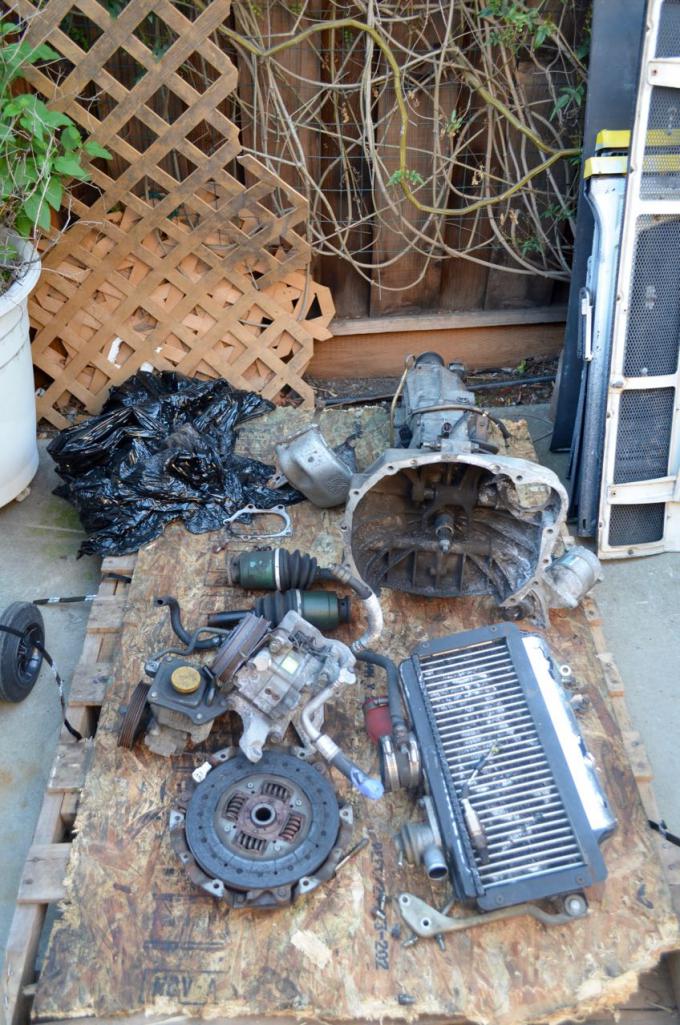

• Broke down the engine/trans, put the engine on the stand
• Cut the backing plates needed to tie the rollcage into the front struts, will weld in tomorrow. No pics yet.

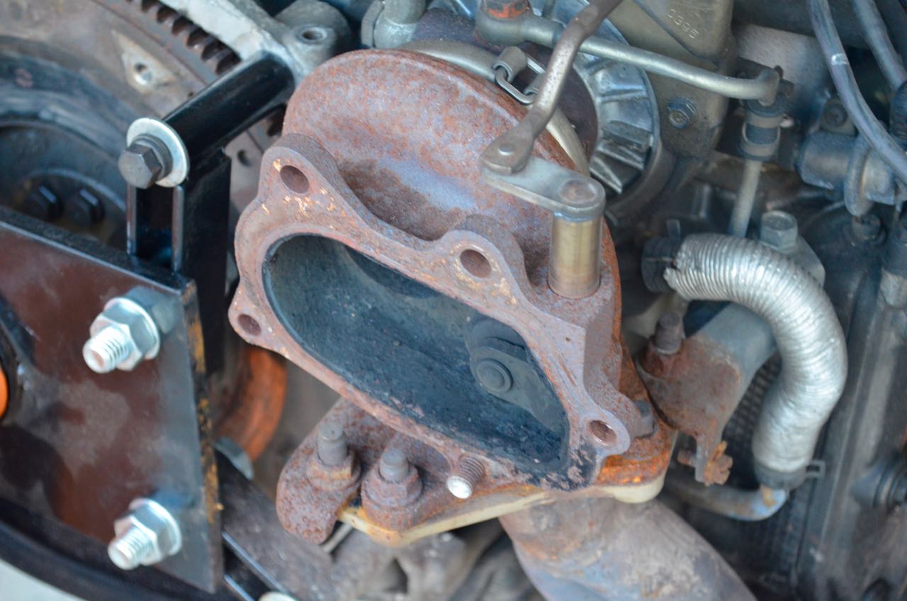

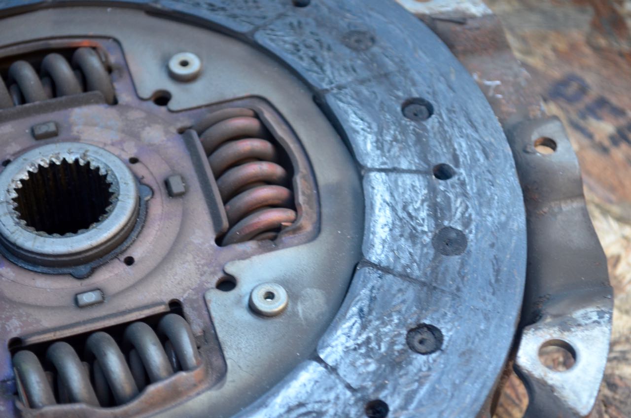

The engine is looking like it was driven pretty hard. The clutch is showing wear and the non-stock exhaust, plug wires, and silicone lead me to believe it was somebody young and reckless, heh. Im sure its fine, but its not quite what I was hoping for when I hit "buy now" on eBay.
