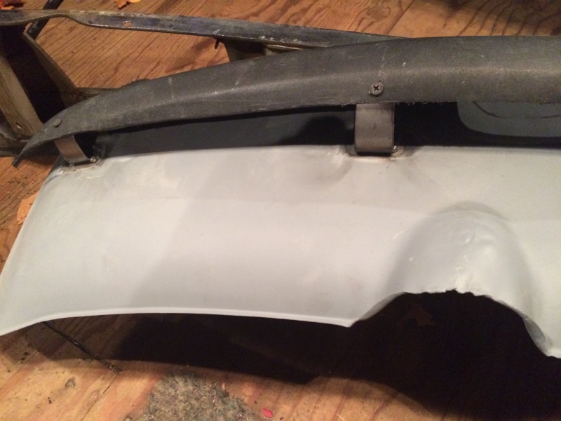

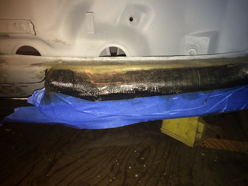

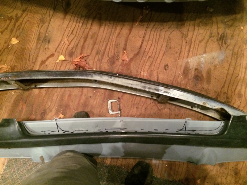

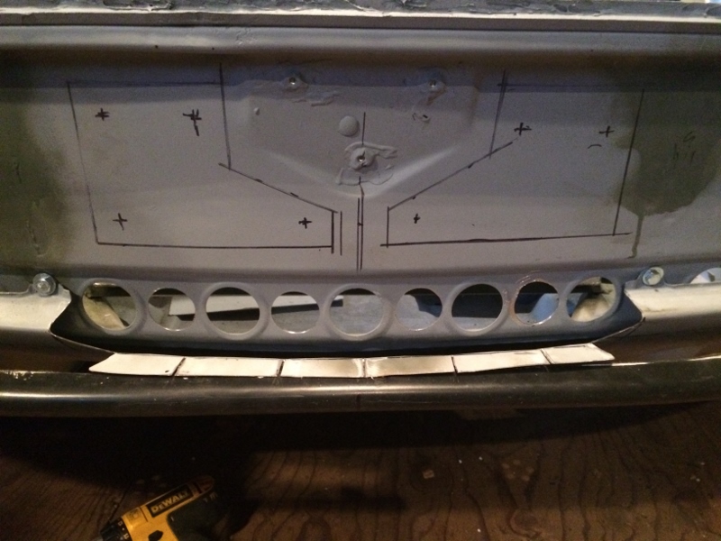

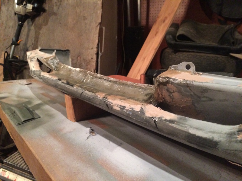

Started by welding on some tabs and the plastic bumper.
(IMG:http://www.914world.com/bbs2/uploads_offsite/i1301.photobucket.com-17072-1455401567.2.jpg)
Cut along the line...
(IMG:http://www.914world.com/bbs2/uploads_offsite/i1301.photobucket.com-17072-1455401567.3.jpg)
Metal tabs support the plastic civic valence.

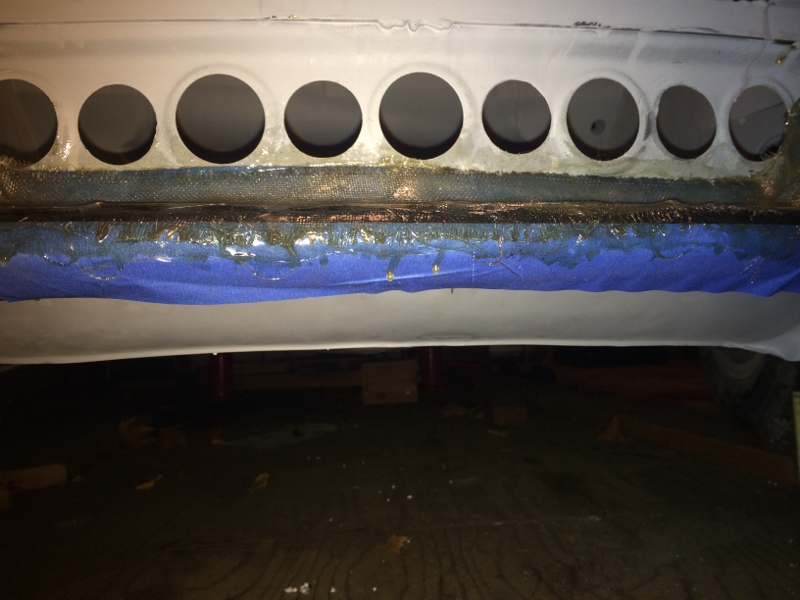

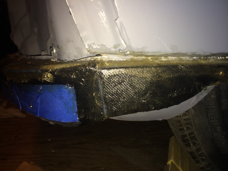

(IMG:http://www.914world.com/bbs2/uploads_offsite/i1301.photobucket.com-17072-1455401567.4.jpg)
Fiberglass covering the metal tabs. This part will scoop the air through
these holes and into the radiator.
(IMG:http://www.914world.com/bbs2/uploads_offsite/i1301.photobucket.com-17072-1455401567.5.jpg)
(IMG:http://www.914world.com/bbs2/uploads_offsite/i1301.photobucket.com-17072-1455401568.6.jpg)
(IMG:http://www.914world.com/bbs2/uploads_offsite/i1301.photobucket.com-17072-1455401568.7.jpg)
(IMG:http://www.914world.com/bbs2/uploads_offsite/i1301.photobucket.com-17072-1455401568.8.jpg)
(IMG:http://www.914world.com/bbs2/uploads_offsite/i1301.photobucket.com-17072-1455401568.9.jpg)

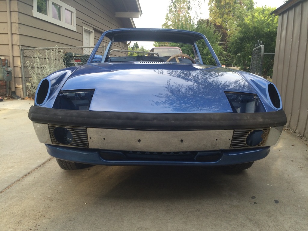

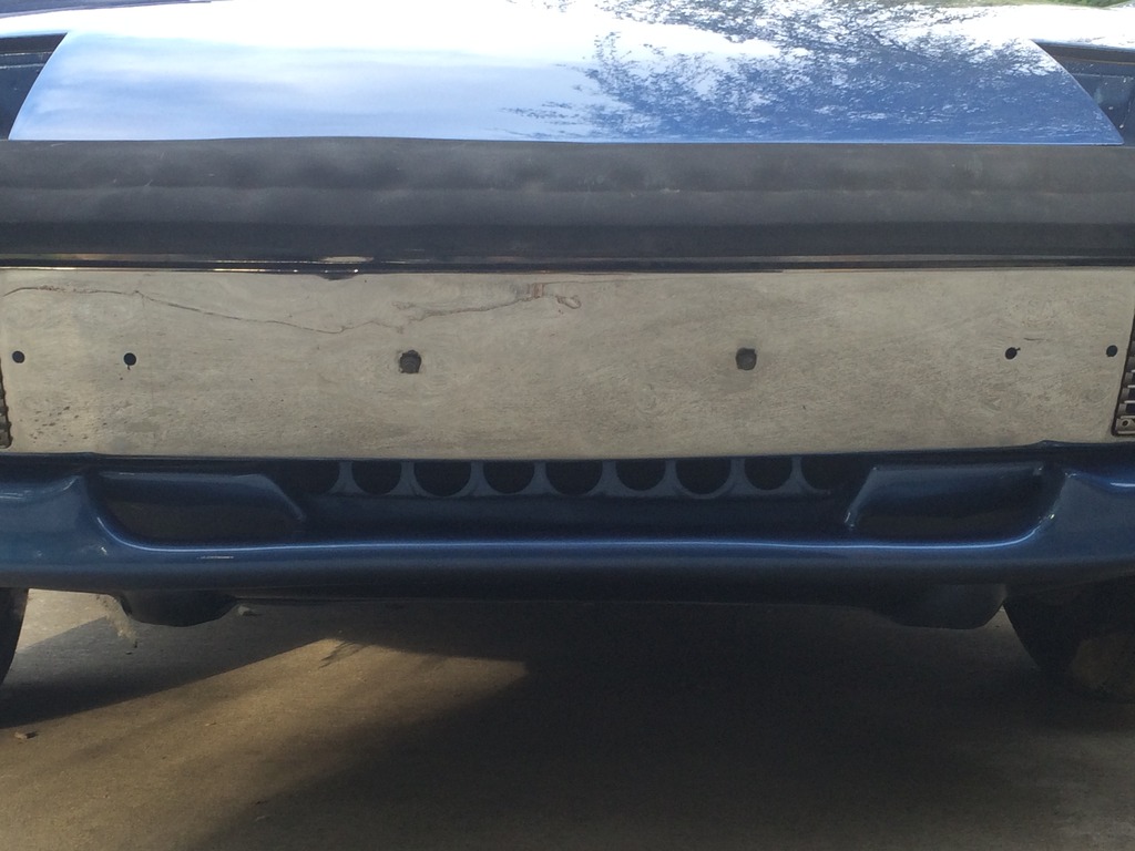

Finally, the final product:
(IMG:http://www.914world.com/bbs2/uploads_offsite/i1301.photobucket.com-17072-1466990210.1.jpeg)
Hard to get a good perspective shot, but here it is. The valence is designed to scoop air underneath the bumper. This will need to be tested to see if we get enough air into the radiator to keep it cool. If not, expect the bumper to get cut out significantly.
(IMG:http://www.914world.com/bbs2/uploads_offsite/i1301.photobucket.com-17072-1466990210.2.jpeg)
