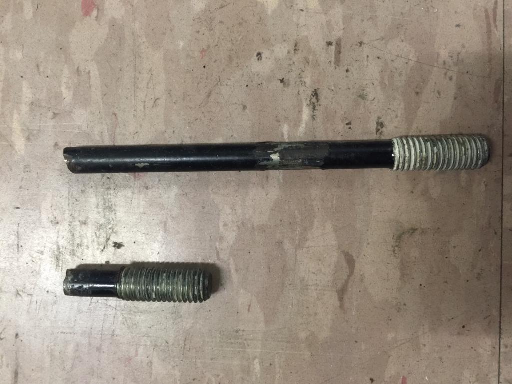

We were putting a 3.2 on an engine stand one day and a head stud snapped and it shot up 2 feet and fell on the floor. No one had touched the stud and none of the others had broken. It was getting a rebuild anyway but still....
We just rebuilt a 3.6, 2 days ago with 4 broken head studs.
