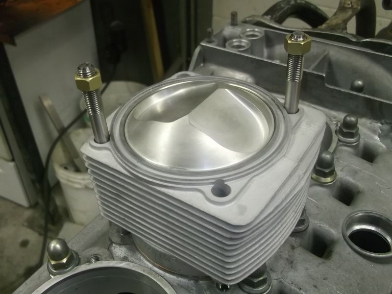

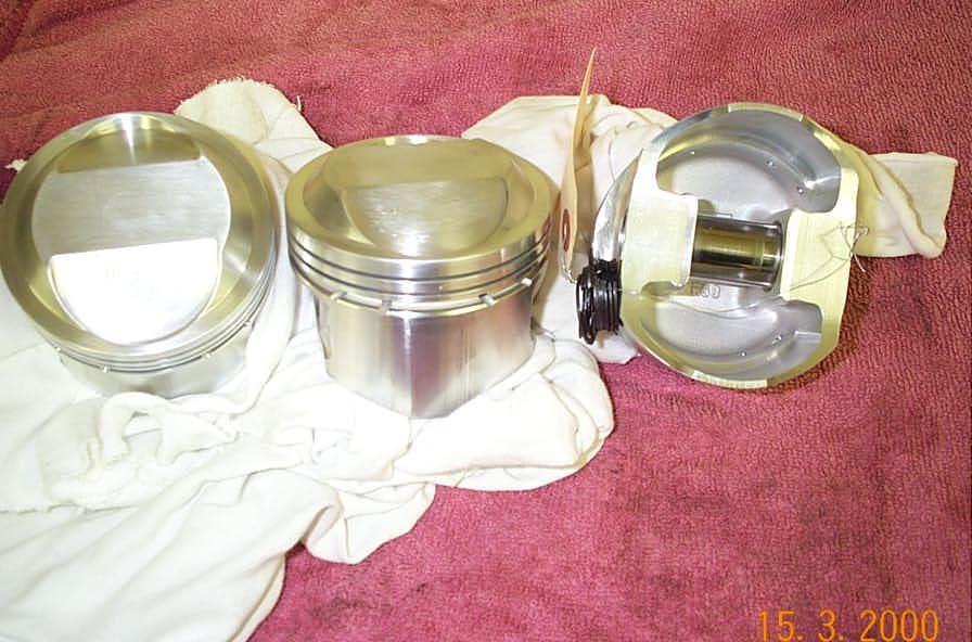

Note the Mahle PCs in the previous pics.
10:1 compression & std 2.7L bore. NOS & I got em' for half price.......couldn't have afforded them otherwise. That was about 2007.
A the time, Andial had them listed at 4600 bucks.(approx). As I wrote previously, the inexpensive days are over......but back then, it was worth every nickel. I have no idea what the tab is now.
The 9.7:1 pistons of my tired engine were pretty damn nice for 7 years of running....both street & AX. These sold quick ( A set of 6) for about 700 bucks.

QUOTE(J P Stein @ Feb 17 2016, 09:38 PM) *
Good luck finding deals on a Mahle P&C kit now, good luck finding Malhe performance set period.
Just posting a pic on Pelican got me a $5K offer on my 3.0 set. (IMG:style_emoticons/default/blink.gif)
(IMG:http://www.914world.com/bbs2/uploads/post-26-1395582448.jpg)
I wouldn't knife edge a crank unless you are full race, really not worth it.
