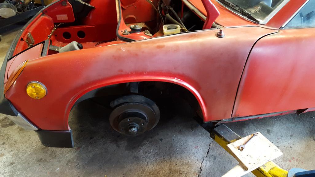

Matty900   Decided to go ahead and fix the damaged fender and...   Feb 18 2016, 12:57 AM
Matty900   Everything is coming apart nicely.   Feb 18 2016, 01:01 AM
Matty900   Getting ready to steam clean everything.   Feb 18 2016, 01:08 AM
Matty900   Very nice red breaks. I guess there was some lefto...   Feb 18 2016, 01:17 AM

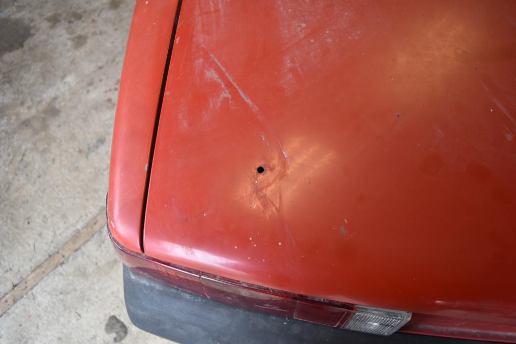

Matty900   Driver's side fender had some issues after the...   Apr 14 2016, 12:39 AM
Matty900   Someone had drilled a few holes in behind the bump...   Apr 14 2016, 12:45 AM
Matty900   Dents are almost all pulled.   Apr 14 2016, 01:14 AM
Matty900   Put down some primer just to keep any rust from st...   Apr 14 2016, 01:16 AM
