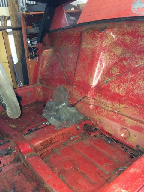

Matty900   Little bit of surface rust in trunk   Feb 4 2016, 08:26 PM
Matty900   Not too bad   Feb 4 2016, 08:28 PM

Matty900   Took off the rocker pannels and there was lots of ...   Feb 11 2016, 01:51 AM
Matty900   What is the best way to take care of this level of...   Feb 11 2016, 10:14 PM

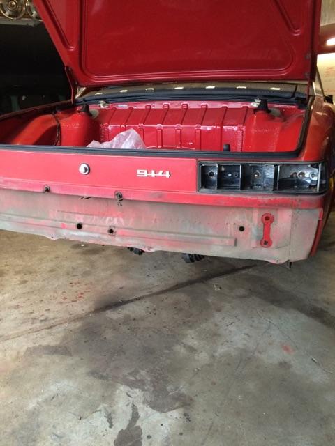

Matty900   Decided to go ahead and fix the damaged fender and...   Feb 18 2016, 12:57 AM
Matty900   Everything is coming apart nicely.   Feb 18 2016, 01:01 AM

Matty900   Driver's side fender had some issues after the...   Apr 14 2016, 12:39 AM
Matty900   Someone had drilled a few holes in behind the bump...   Apr 14 2016, 12:45 AM
Matty900   Dents are almost all pulled.   Apr 14 2016, 01:14 AM
Matty900   Put down some primer just to keep any rust from st...   Apr 14 2016, 01:16 AM

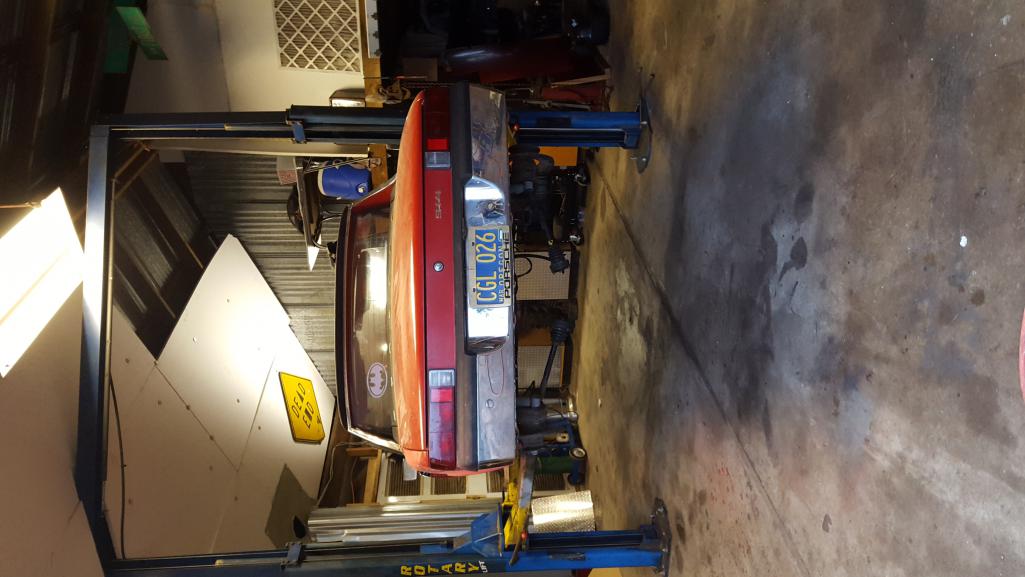

Matty900   A few nights a week to get work done, but a lift, ...   Mar 24 2017, 01:09 AM
Matty900   The car is in great shape and all of the nuts and ...   Mar 24 2017, 01:14 AM
