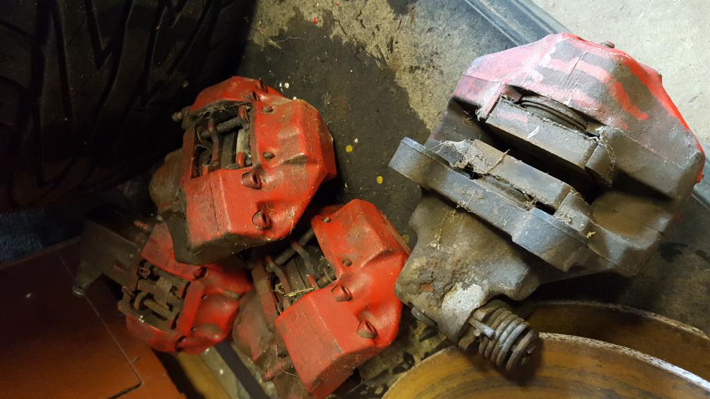

Very nice red breaks. I guess there was some leftover in the can after the fender. Sent these off to Eric at PMB. Will be replacing breaks, bearings and suspension all the way around.
Now I just need to find a factory front swaybar. Anyone have one they are willing to part with?
