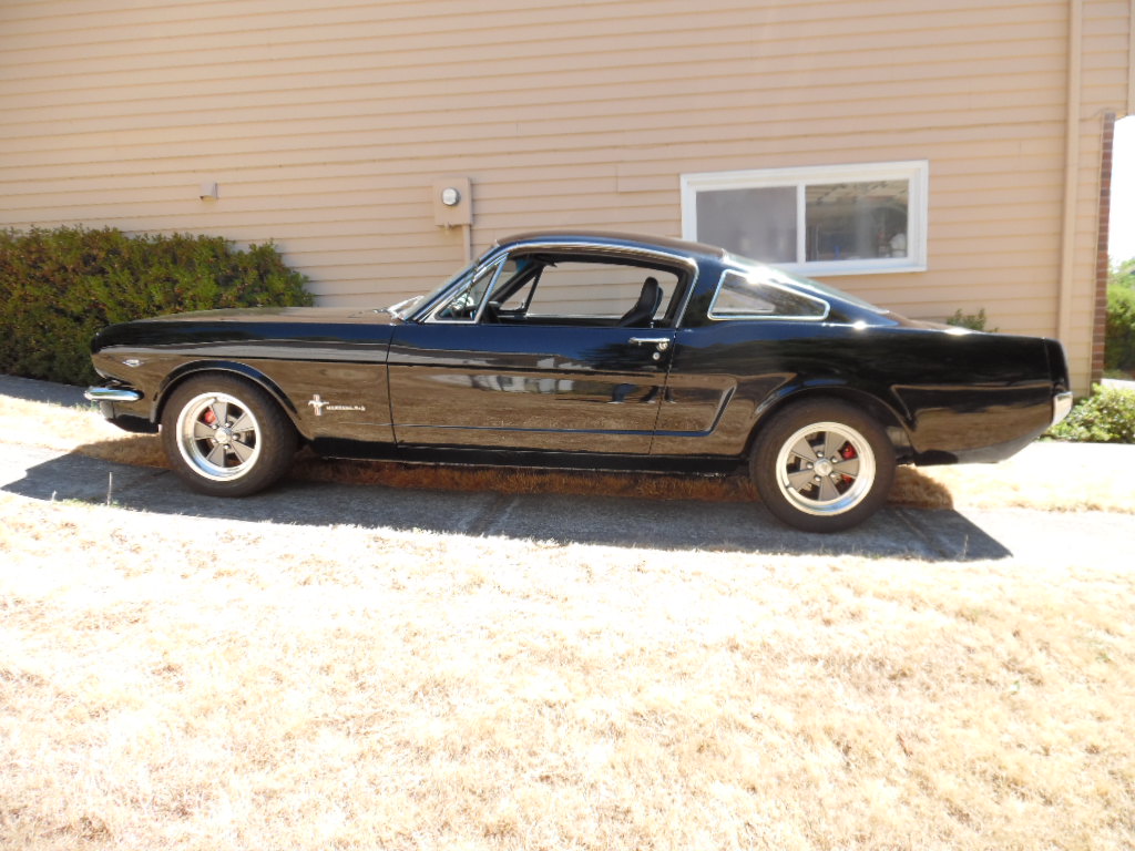

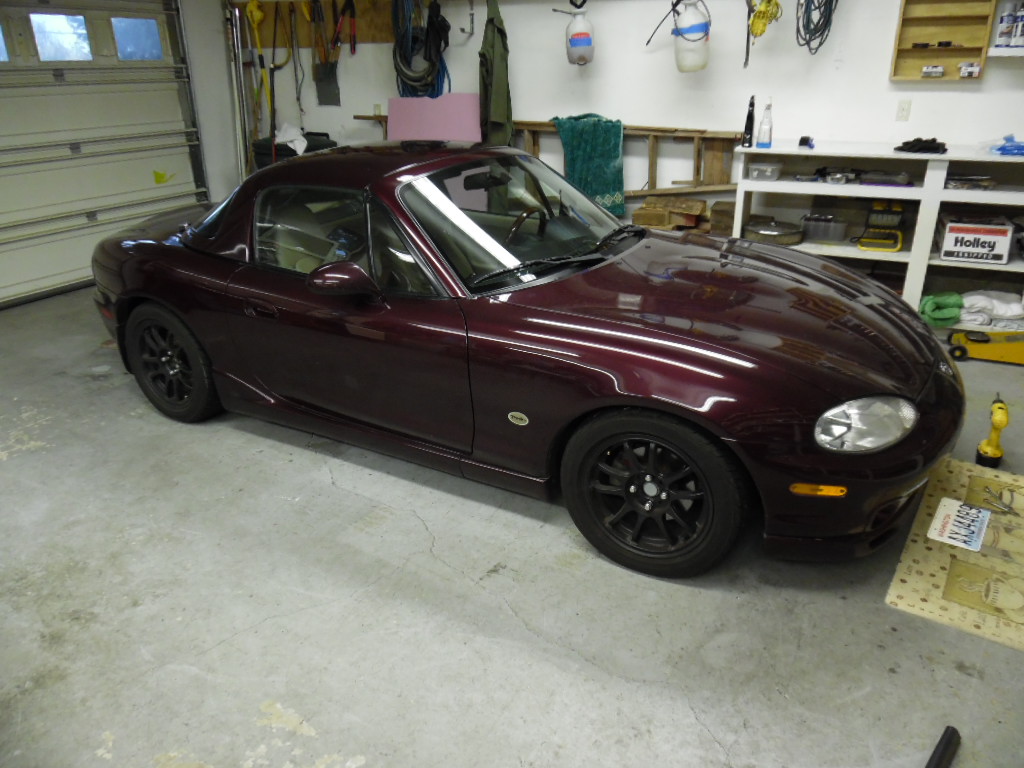

I sold all my Porsche stuff and bought a 65 FB Mustang...got fed up with that & bought a Miata. My wrenchin' days are over. Nice talkin' to you.
