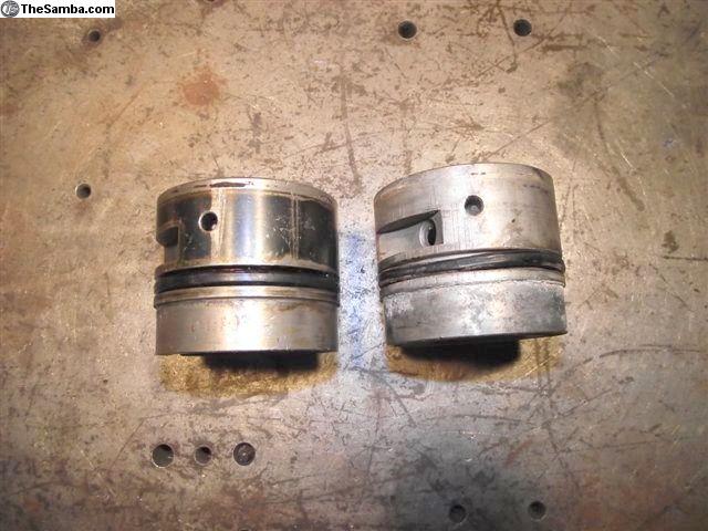

Another rebuild tip, Don't toss that Number 8 bearing If it fits smoothly on the journal and has no rocking, it is likely still within spec.
Two brand new 964 #8 bearing, one from Vertex and I believe the other one was from the Bird were way out of spec in the ID like something outrageous 1mm (.040, maybe only half that, but it was crazy out of spec.).
They may have fixed this issue by now, but I'd check your tolerances very carefully.
I checked my old bearing OD and ID and they were within spec, so I did the DFL treatment on it and reused it.
