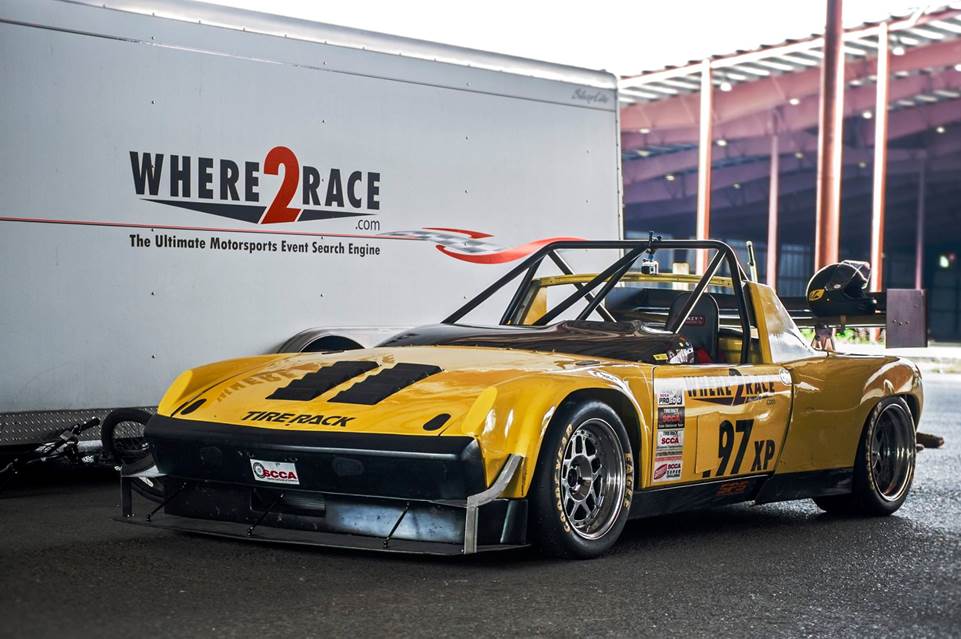

Nowdays, Subie is the way to go IMO.
MY ex-co-driver bought my race car and went with a JDM Subie along with some engine performance mods. He now has power in abundance. 12inch radial slicks have trouble dealing with it. Such extreme measures are not necessary for "normal" folks.
The cost of that swap are less than half the cost of Porsche power.......and you can get MORE.....the T-4 is a POS and the old 911 motor is obsolete .The biggest problem is transmission. He went with a 930 box with a flipped ring gear......which ain't cheep. He also solved the 914's front suspension
by shitcanning the whole works and going to an Elise set up.
Other trans are an option, but I don't know enough about them.
His car is now killer.
