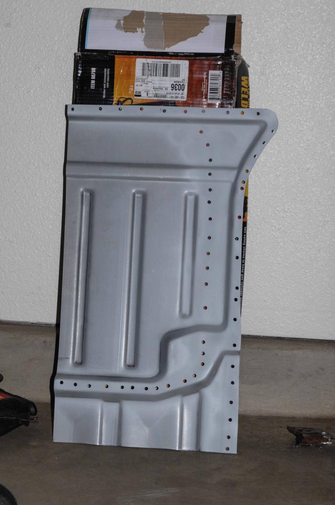

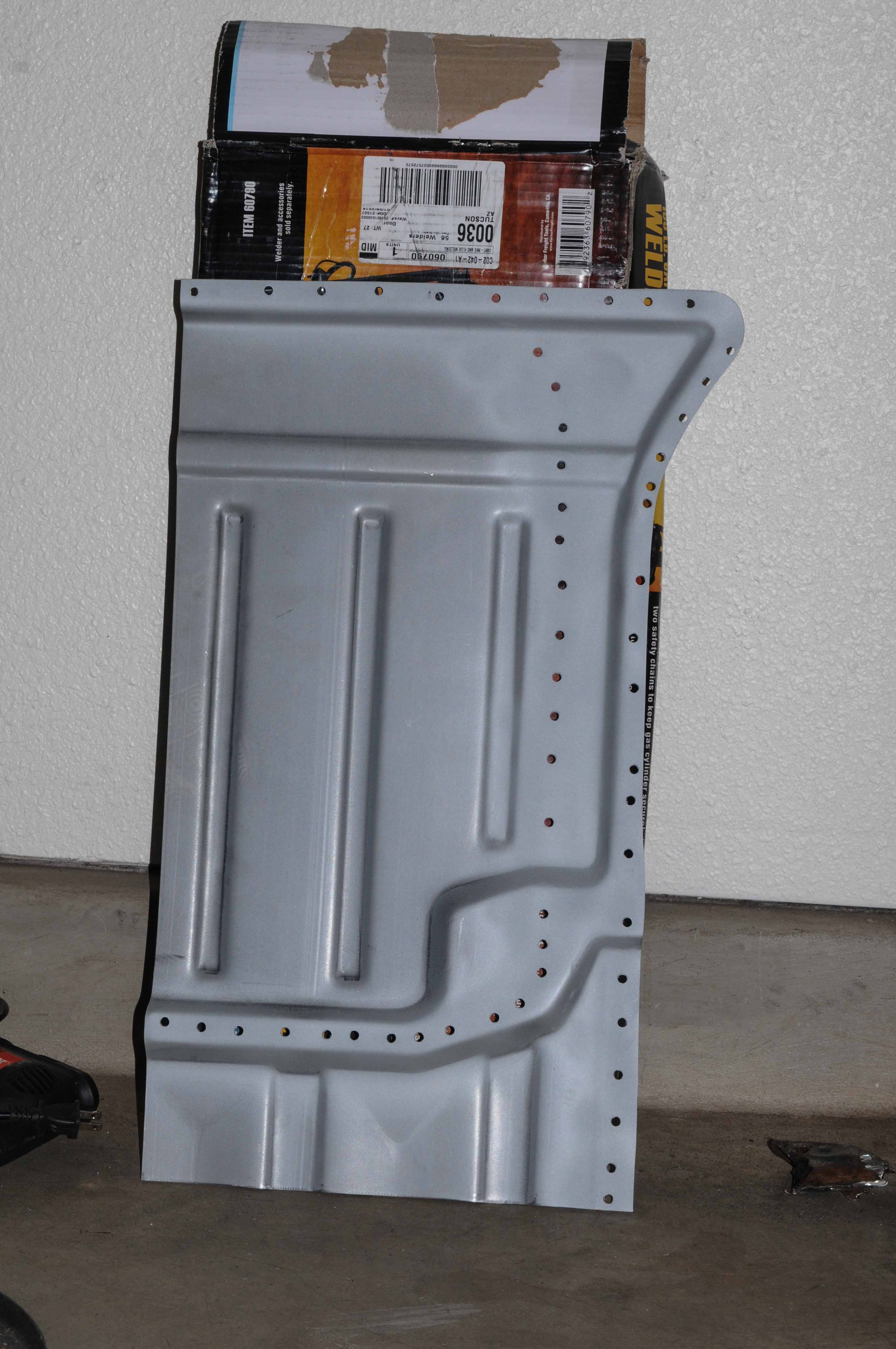

We picked up a new class of students this week so it was a short, 1 day weekend. So I spent it getting the floor piece ready to weld in, but then realized it would be easier to fix the lower firewall pieces with the big hole there, so I fabbed and welded in some pieces. Just a note and a question: My plan is to get the pieces welded in and a quick, rough grinds, I'll then go back for finishing/cleaning/prettying during paint prep--one area at a time. Is that a bad idea?
