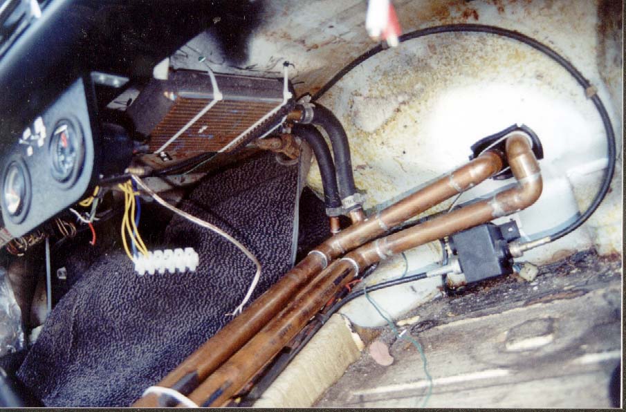

Do it like a Buel, run it through the frames, Porsche also did the same thing on the 917. In your case, add some DOM and run it that way. More of a joke than a solution BTW, But I have thought about it.
One of the first documented sub conversion did it right down the tunnel with copper pipe.
Might not be the way you would go, but it has been done.
