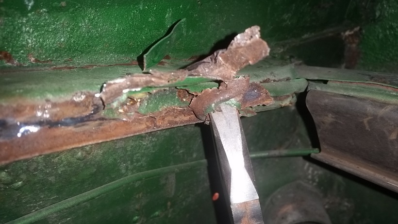

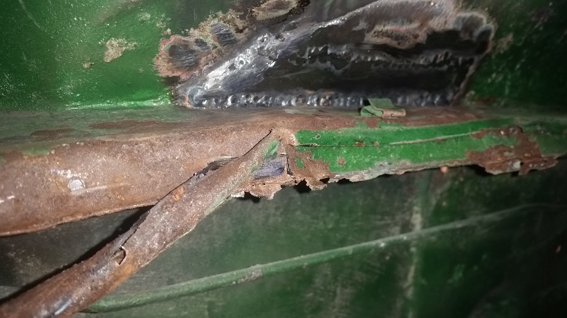

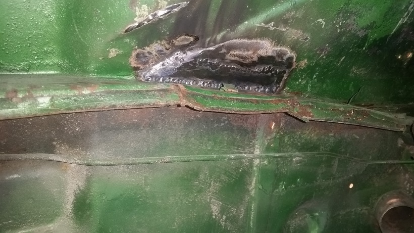

This piece is something that needs to be treated with kids gloves. The three cars I've worked on have a lot of metal degradation on the bottom. I used multiple weapons in order to bend it back into place. But primarily I used a wooden block and a hammer.
After bending it back into place I see that combination of the water sitting in the crease and me bending it back into place tore a hall in the fire wall. (IMG:style_emoticons/default/mad.gif)

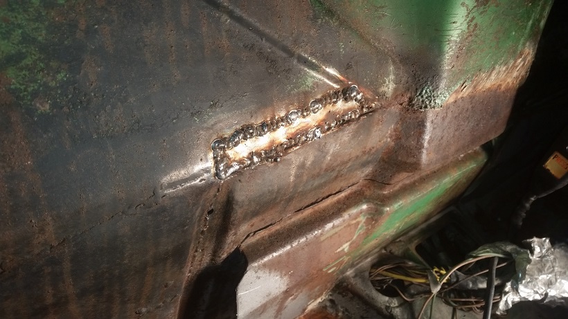

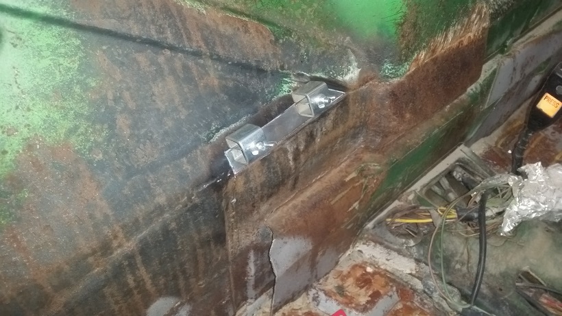

So a patch is in order. Bigger is better. Make it big enough so that your welding on thicker metal. I'd like to say good metal, but thats not always a possibility.
Welds are a little proud (tall) but I'm giving it just enough heat to get a good weld. Anymore and we're looking at the engine compartment.
Backside was a little tough to clean up. The shelf is just long enough that you have a tough time getting a grinder in there. Even with my vast assortment

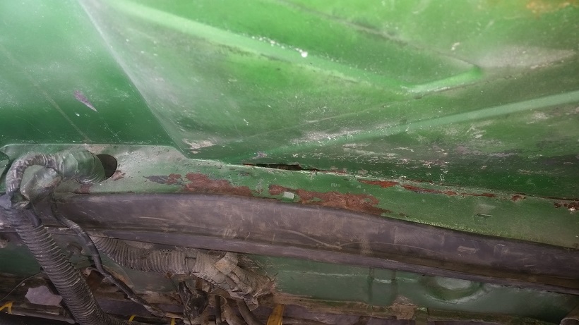

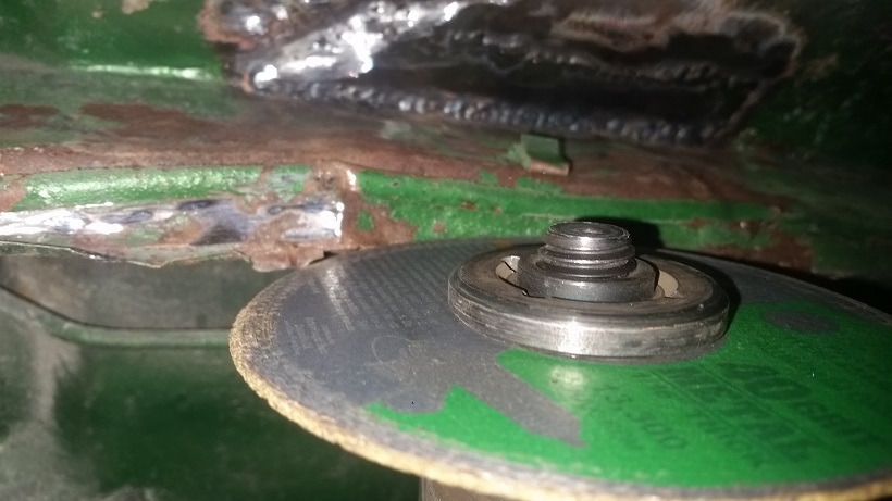

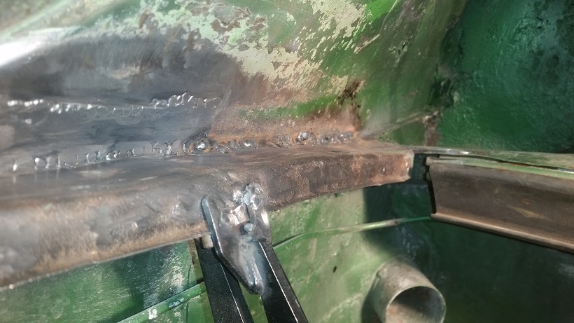

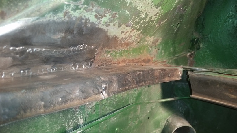

I decide the engine seal needs to come off so I can get to the bottom weld and clean up the tray for a shot of primer. Surprise, surprise I find that the seal channel is bent to hell and all rusted up.
Sorry the shot had poor definition of the channel
So thats going to have to be replaced. If I don't have enough left over in the scap pile. I'll cut it off the parts car. Knowing how soft the shelf is I decided to used Rick's screwdriver method on the spot welds. Basically you thin the top surface with the grinder and pop the weld off.
Peeled it off like using a p38 can opener. Used lineman's pliers as the roller.

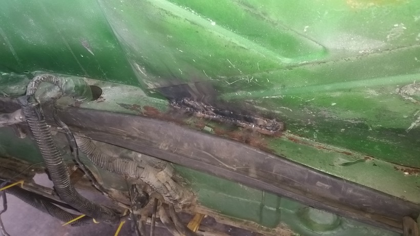

It's 5:10 and I decide to roll the dice and weld the remainder of the seam over to the top of the hell hole. I'm thinking, am I getting to cocky? Its pretty rusty.
Took about 20 minutes but I got it with out much fuss. A couple spots kicked up a bit, but all in all went ok.
