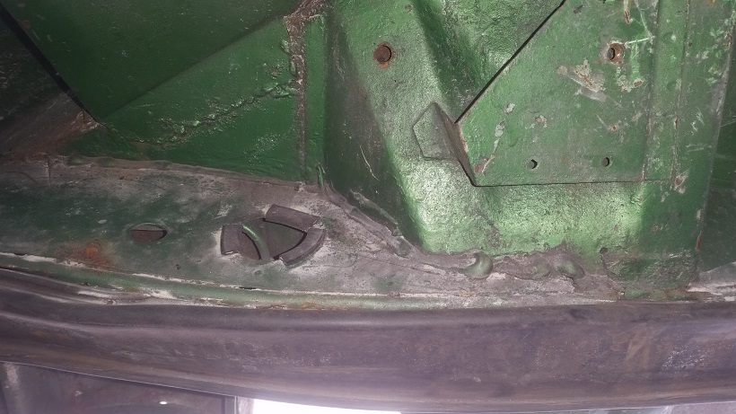

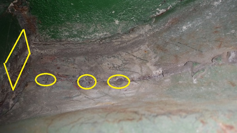

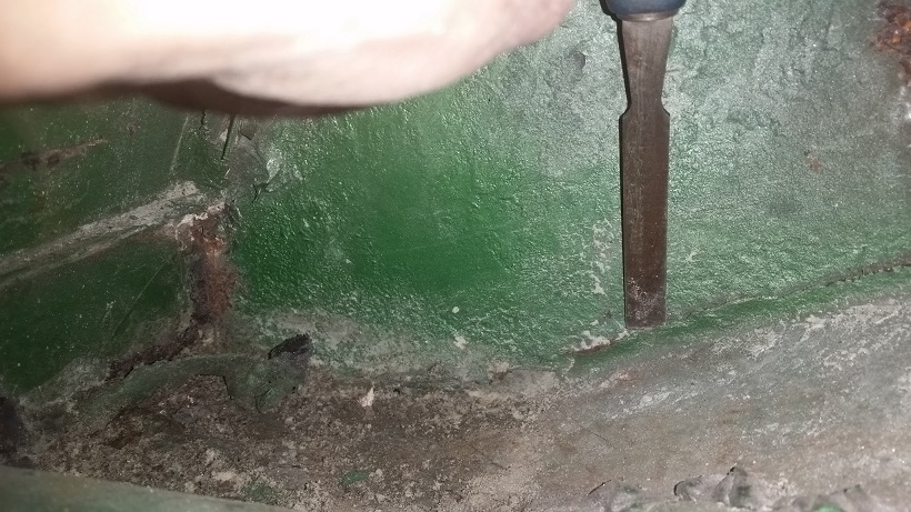

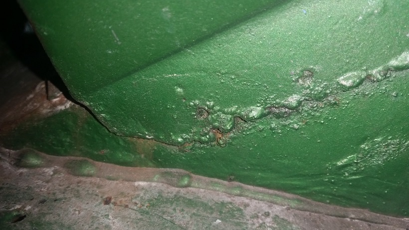

Hell Hole research .............
Ok here's what I see ............
New battery tray and support ... install is over welded (IMG:style_emoticons/default/sad.gif) removing it would be kind of messy.
New right engine shelf .......... used silicone as the seam sealer (IMG:style_emoticons/default/idea.gif)
Upper long (hell hole) looks solid. Hell hole end panel (firewall) needs a patch.
Engine shelf welds didn't get ground down. (IMG:style_emoticons/default/idea.gif)
Here's what I see created the outer long rust issue. The flange/seam from the upper long to the wheel house has let go. (IMG:style_emoticons/default/barf.gif) Which allows moisture and or battery acid to slide down between the two layers.
Tomorrow (Friday) I plan to carefully peel off the outer layer of the outside upper long to investigate further. I wish I could figure out a way to get my camera down in there to get a better look.
