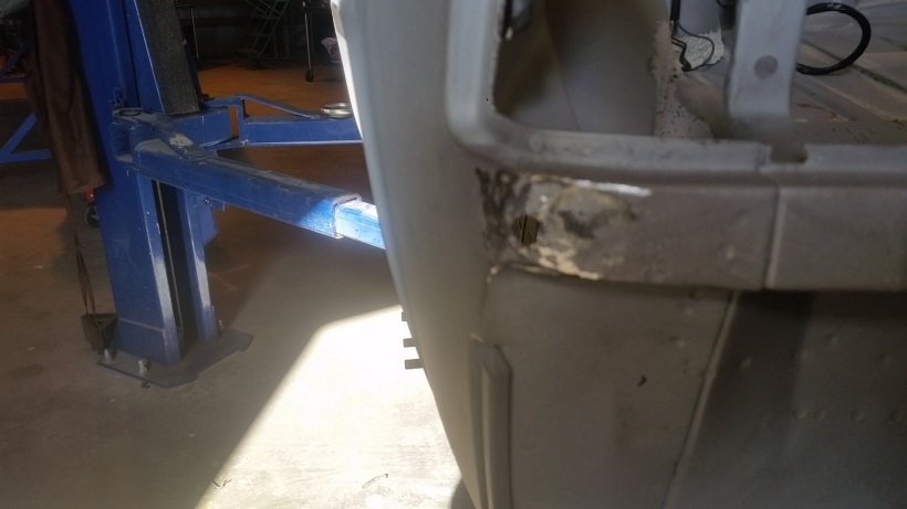

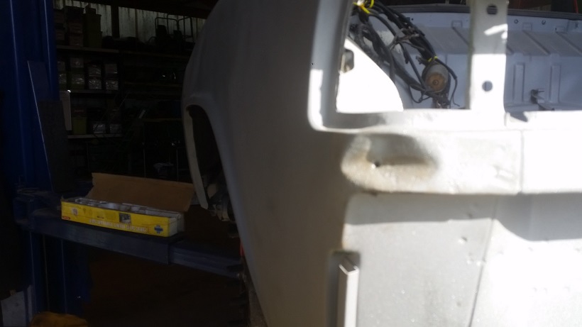

Today the team was back together.

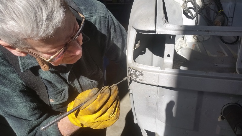

Super In Law went after the big dimple in the left rear corner next to the tail light.
He spent quite a bit of time with the slide hammer to it get it pulled out.

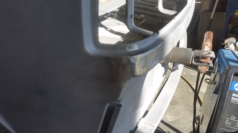

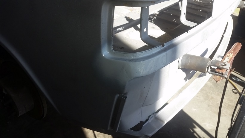

I used a formed plate to plug weld it.
It will take a smidgen of All Metal to make it perfect. But I didn't want to over work it.
Filler will be applied after the car gets epoxy primered.
