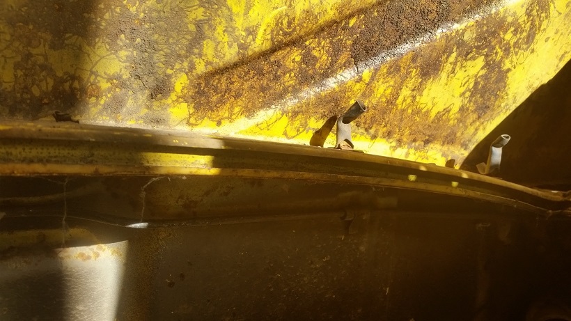

I start the day digging thru my stash looking for some engine seal channel. No such luck.

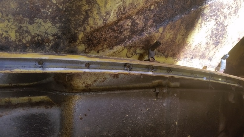

So me move over to the parts car. It's amazing how nice some of the sections are. Then some others ...........not so much.

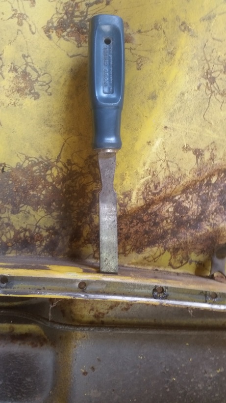

I'm using Rick's spot weld removal technique again. But this time I can drill all the way thru to make it easier.
Popped it off with an old chisel.

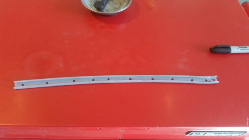

Ran the piece of channel thru the bead blaster.
