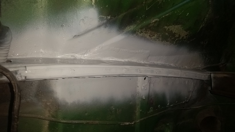

Next I need to close up some of these holes on the engine side of the firewall.

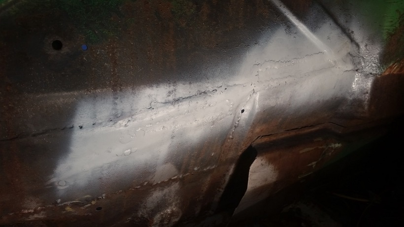

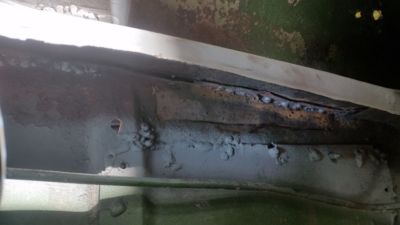

This hole was patched over from the inside. (IMG:style_emoticons/default/sad.gif) Not good.

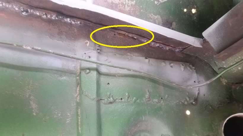

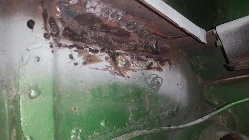

Because it is double walled I cut back all the rotten stuff.
Welded the top seam of the other hillbilly patch also.
Installed the new piece of engine seal channel and gave her a coat of self etching primer.
Here's a shot of the inside.
