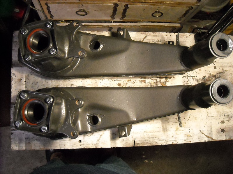

I installed the new bearings into the rear control arms. also installed the Elephant racing Rubber bushings.
YES it is as big a PITA as others have said. No pictures of the installation..
But a good friend had just bought a HF 20 ton press and that gave me an excuse to go visit and spend a couple hours. No problem getting your hands clean after all the liquid soap we had slathered around. eventually we got the shafts pushed in nicely.

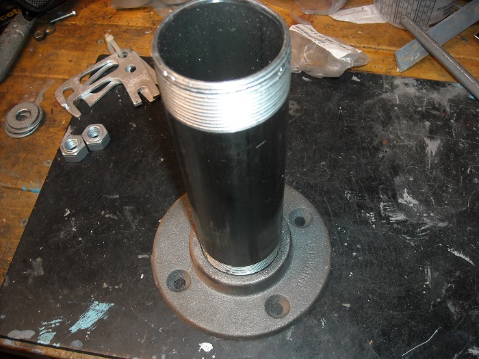

I whipped up this tool out of plumbing supplies to support the rear of the wheel bearing when we pushed the hubs in with the press.
2" pipe with a floor flange. worked great , don't know how often I will use it again though..

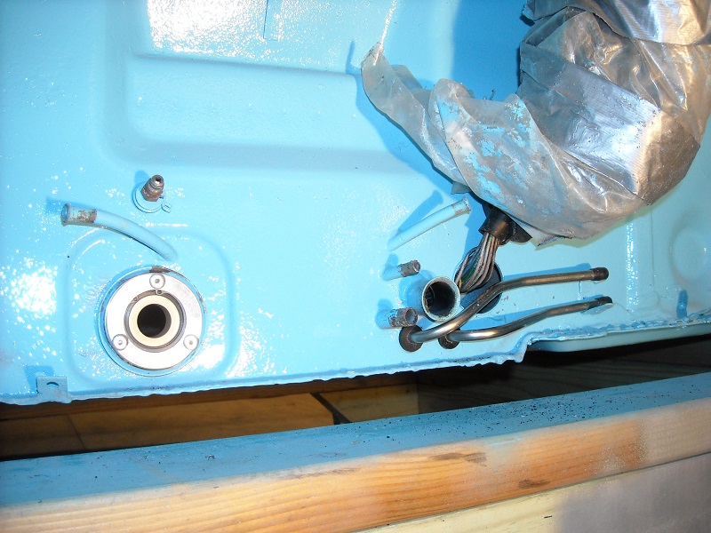

Installed the Tangerine shift rod bushing into the firewall and then installed the SS fuel lines. both operations went smoothly.

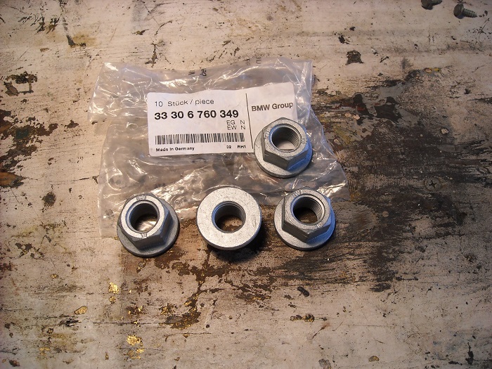

needed new nuts for the rear control arms and after an exhaustive internet search came up with a BMW part that I like more than the stock original parts. they are flanged all steel locking nuts.

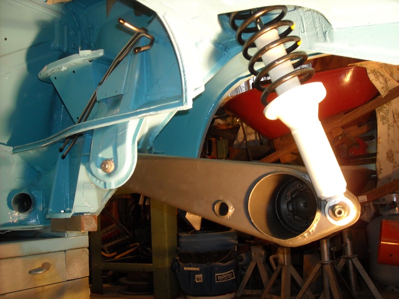

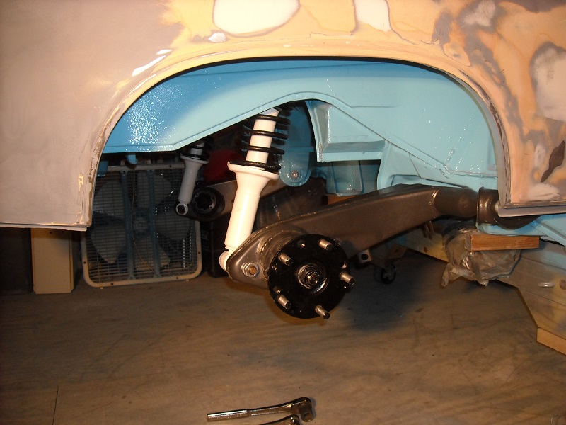

got the rear control arms bolted up and you can see the new flanged nuts in this pic. also the other tangerine SS lines. installed just so I don't lose them.
Yes they are KYB shocks.... I know they are not the favored shock around here but I got a good deal on the set from a friend that only had them on a little while then upgraded to Konis all the way around...
I figure they are an easily replaced item if I don't like them..
I think I will work on replacing the tunnel brake lines next and after I gather the rest of the lines up start to bend new ones. One of my first purchases when I started this project was a line set from AA, it is supposed to have all the lines precut to the correct length with ends already installed. we shall see how that works. Had I know earlier I would have gotten the prebent set from PMB and just been done with it.
So now I have suspension. (IMG:style_emoticons/default/aktion035.gif)
