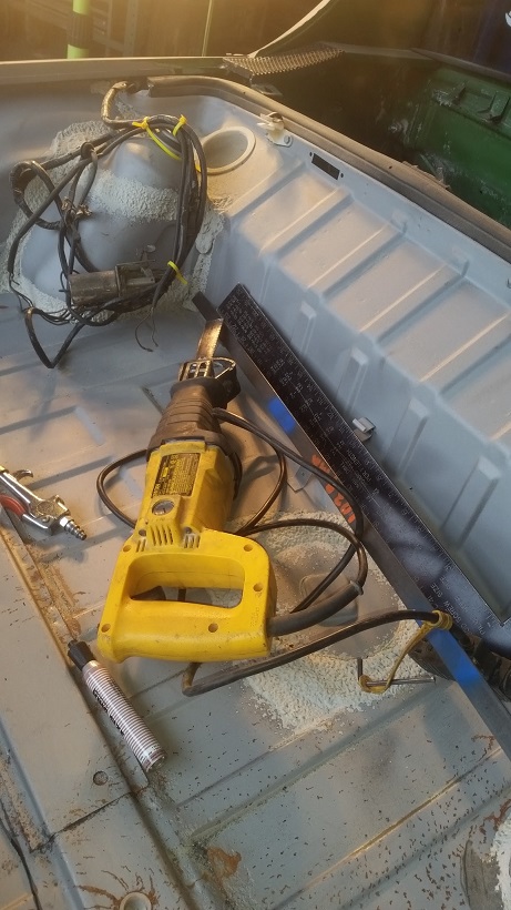

Decided to jump into removing the rear panel. This is the first 5 mph bumper that I've worked on. I had no idea that the rear trunk panel was different. The corners are different, they have a hump over the bumper mount. The bumper mount is tied into the transmission mount. But its still spot welded to the trunk floor pan.

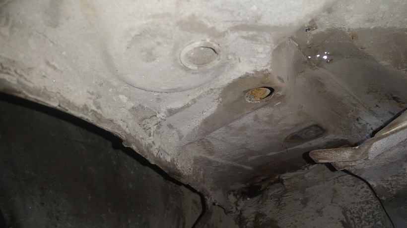

Here's a shot of the bottom side of my 73.

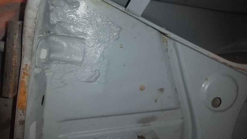

Here's a shot of the 75.

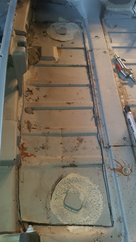

Step one was to figure out what I was going to replace on the trunk pan. Plan A is to remove up the transmission mount hump like must folks are doing. Sketched out the cut lines. Opened up some slots for the sawsall blade and went to work.
The pan comes out first. That will eliminate drilling out all spot welds across the middle of the rear panel. Both saving time and spot cutter bits.
