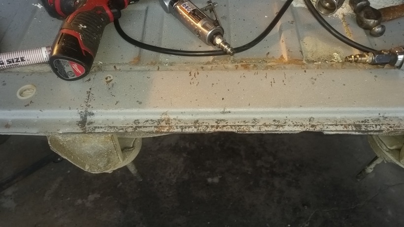

I've been asked by Mark to do some sheet metal/body work on his 75 2.0 Liter project car. The car arrived last Monday. But I needed to finish up a couple things on my project car and in my shop first. But I dove in this afternoon.
First task is to tidy things up after the paint stripping. Which included dropping the engine in order remove any residual media in the nooks and crannies. I was concerned with the rust prevention product that Dustless Blaster mixes with the glass media being left on and in the electrical connections. I'm a firm believer of an ounce of prevention is worth a pound of cure. I dribbled some OSPHO on a couple connectors in my white car. Not good. It ate the crap out the plating.

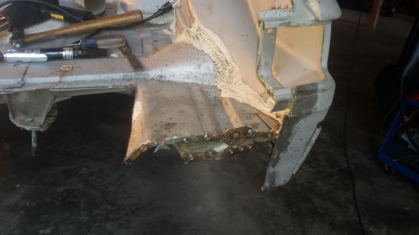

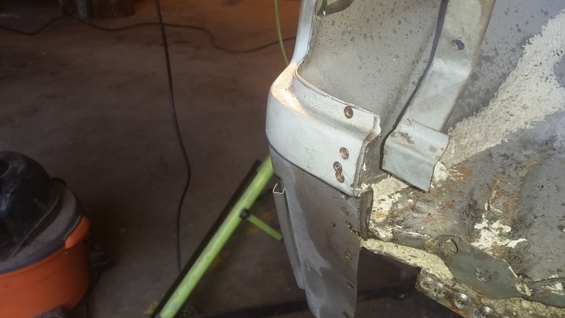

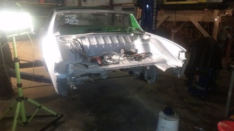

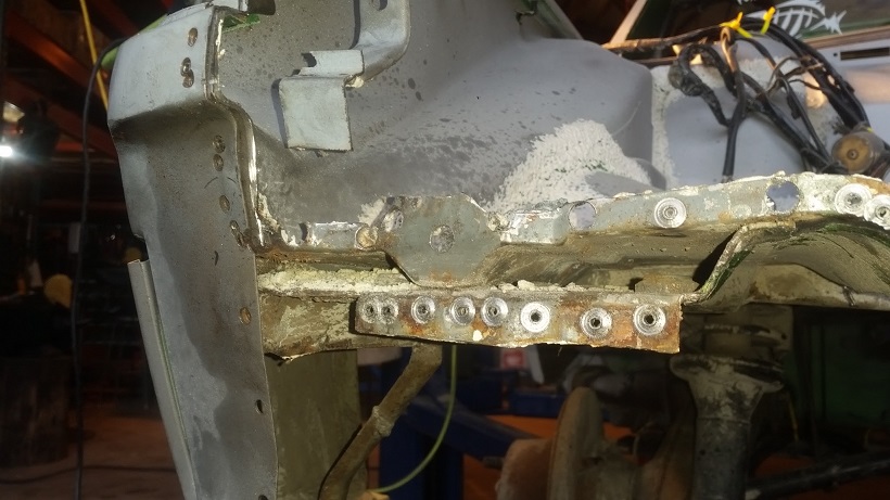

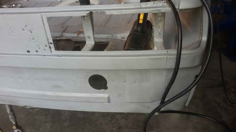

BEFORE :
AFTER :
Here's where I ended the day. For one I didn't leave myself much of a tail to pull the remaining rear panel portion out with. (IMG:style_emoticons/default/headbang.gif) Two, something is hanging up where I have the two yellow arrows. It will take some more detailed seam sealer removal on the back side for starters. Then take a closer look for another spot weld.
Heading home. Saturday AM is an autocross tech session. Followed by a lunch meeting. Then an afternoon meeting with Mark.
