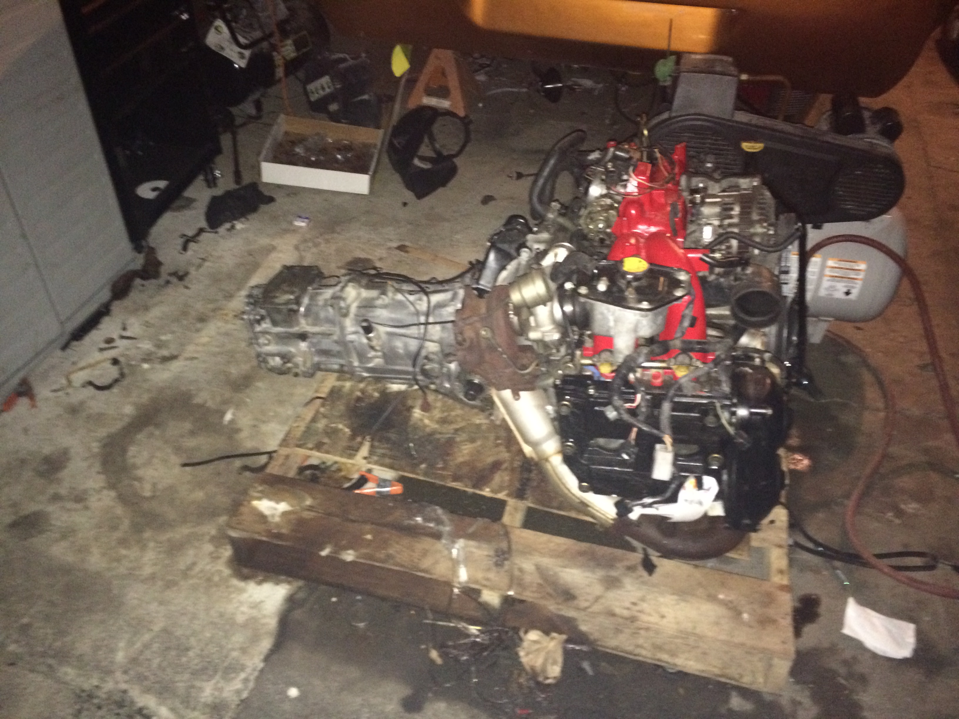

Hello ive thought about doing this for a while but lately ive had an itch and lots of questions and little want to open 1000s of threads so here it is. Subydoo i bought a 1970 914 from a one legged guy in my home town who bought it from a crip in a neighboring city. straight off the bat i knew i was gonna ej turbo swap it.Attached Image

Update!Ive finished lining the interior and floor pans. In much more cool news after many attempts, two different clutches and, two flywheels my engine and transmission are together! (kinda like pandas, many attempts to get them together) soon i will have the trans hangars from ian and a new motor mount welded in.
