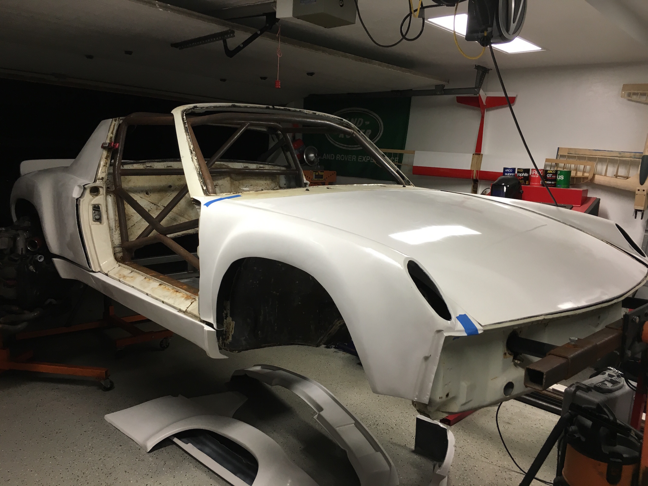

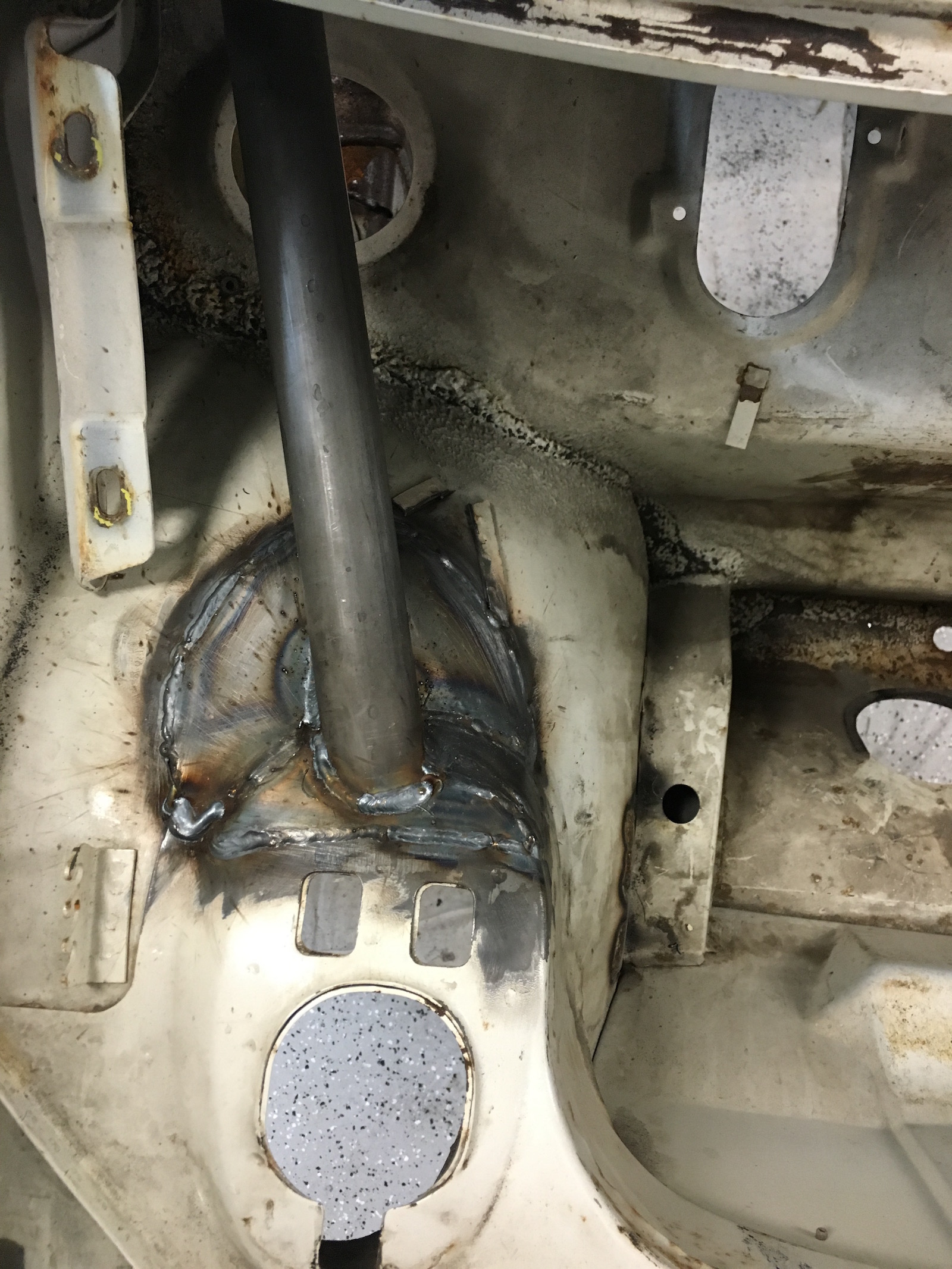

Had a couple of good nights of work lately:
- Tied the cage into the front suspension points, its now an official 8-pt cage
- Working on gusseting the cage in a few places, no pics at the moment
- Purchased the fiberglass body parts from Rennspeed.com
- Did some more work on the floorpan, need to purchase pedal set before I can do more
- Worked on reinforcing the dog-ears, still in progress
- Found a solution for plumbing the engine coolant up to the front trunk, cut the holes in the longs to route the green-stripe hose I plan to use.
- Fit the engine lid today, made it go around the roll cage
- Bought an MR2 shifter, haven't started mounting it yet.
- Researched lexan windshield options, parts needed for the engine, suspension options, vents for the hood, and a bit more. The research takes the longest, just of forum time, eBay, Craigslist, and of course 914World.com
I need to pick up the pedal cluster and the radiator before I can do much more. Once I have the pedals, I can get them mounted firmly to the pan, then the pans can both be welded in. Then I can mount the seat and the shifter. Once thats done, the car can be shipped out to the media-blaster for cleaning and paint. Then its all just fitting the panels, putting it down on the suspension, installing the engine, and we're in business.
