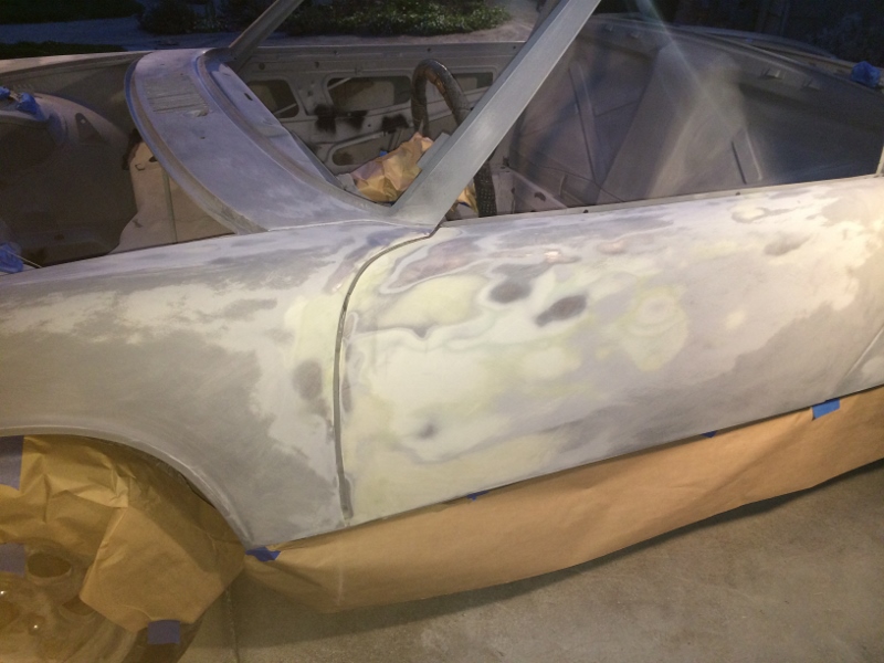

Now we are ready for final prep work which included block sanding with 80 and 180 grit. We used foot long blocks made of a flexible rubber, with velcro on the sides. Scott also uses a metal file to knock off the high points. Scott marks the low spots with a circle and the high spots with an "X". The low spots are then filled with glazing compound, a very thin filler, and sanded with 180 grit. He also used an air sander.
(IMG:http://www.914world.com/bbs2/uploads_offsite/i1301.photobucket.com-17072-1456678354.1.jpg)

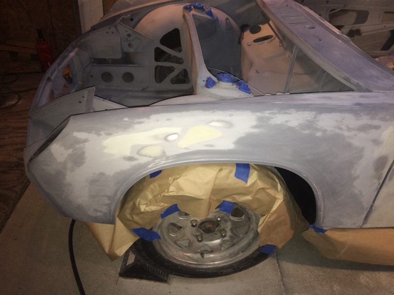

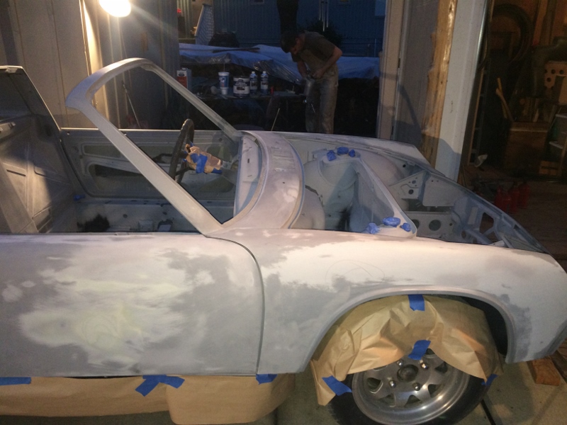

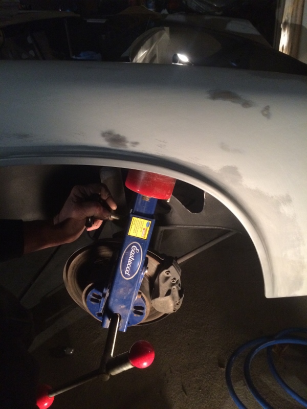

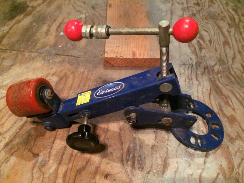

One of the steps we took was to roll the fenders to give them a better shape. We only moved the fenders a quarter inch, but rolled the lips and got rid of the funky inward curve of the shape when looking overtop the fenders. It is amazing what a subtle change like this can do to the aesthetics and functionality.
(IMG:http://www.914world.com/bbs2/uploads_offsite/i1301.photobucket.com-17072-1456678354.2.jpg)
(IMG:http://www.914world.com/bbs2/uploads_offsite/i1301.photobucket.com-17072-1456678354.3.jpg)
(IMG:http://www.914world.com/bbs2/uploads_offsite/i1301.photobucket.com-17072-1456678355.4.jpg)
(IMG:http://www.914world.com/bbs2/uploads_offsite/i1301.photobucket.com-17072-1456678355.5.jpg)

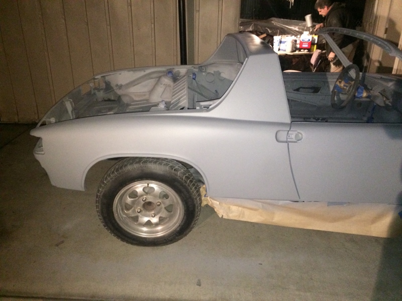

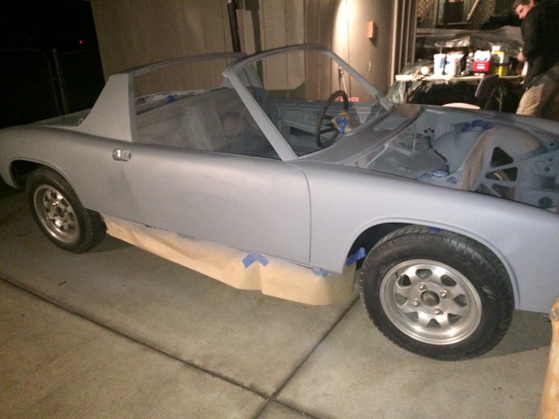

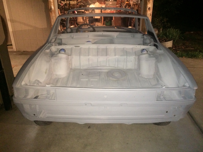

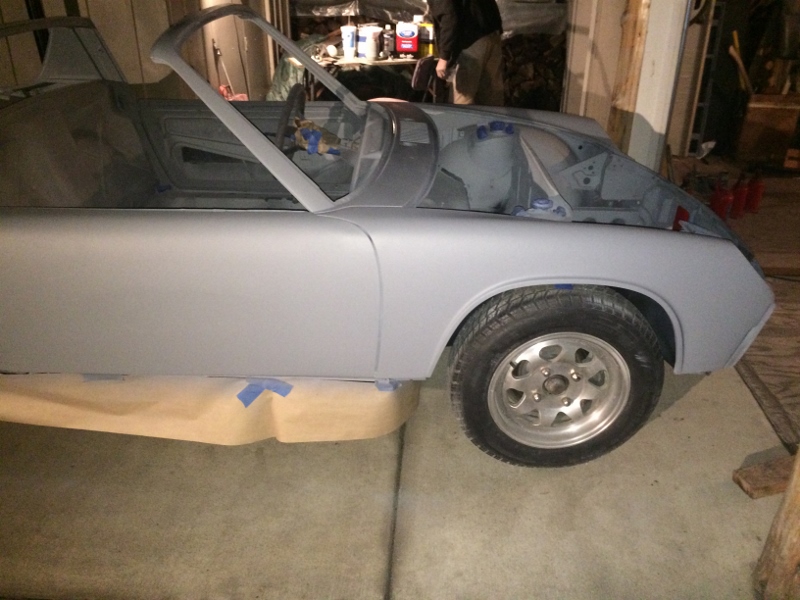

This is what the primed car looks like. This is "two laps around" the vehicle, or two coats of Urethane primer separated by 10 minutes of drying.
(IMG:http://www.914world.com/bbs2/uploads_offsite/i1301.photobucket.com-17072-1456678355.7.jpg)
(IMG:http://www.914world.com/bbs2/uploads_offsite/i1301.photobucket.com-17072-1456678356.8.jpg)
(IMG:http://www.914world.com/bbs2/uploads_offsite/i1301.photobucket.com-17072-1456678356.9.jpg)
