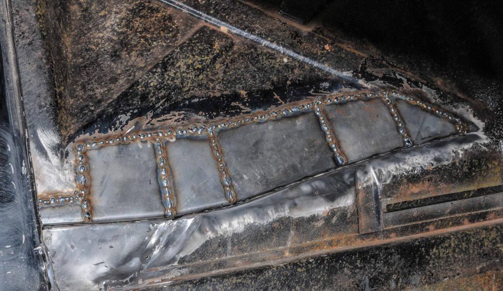

This weekend's goal was to tack the floor section in and finish making the firewall. I actually met my goal. Due to the curve at the bottom of the upper firewall, I found it easier to make it in sections rather than one big piece. I decided to make a photo sequence of my grinding technique: I first hit it with the grinder to get the tallest, toughest spots, then I switch to a rough grit flap disc and work my way to smoother discs. There are still some holes to be filled and grinding to be done, but that will come later when it's time for finishing/paint prep.
