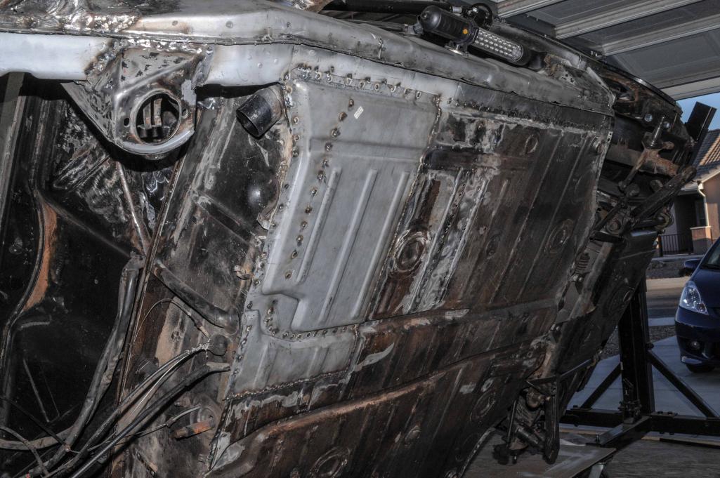

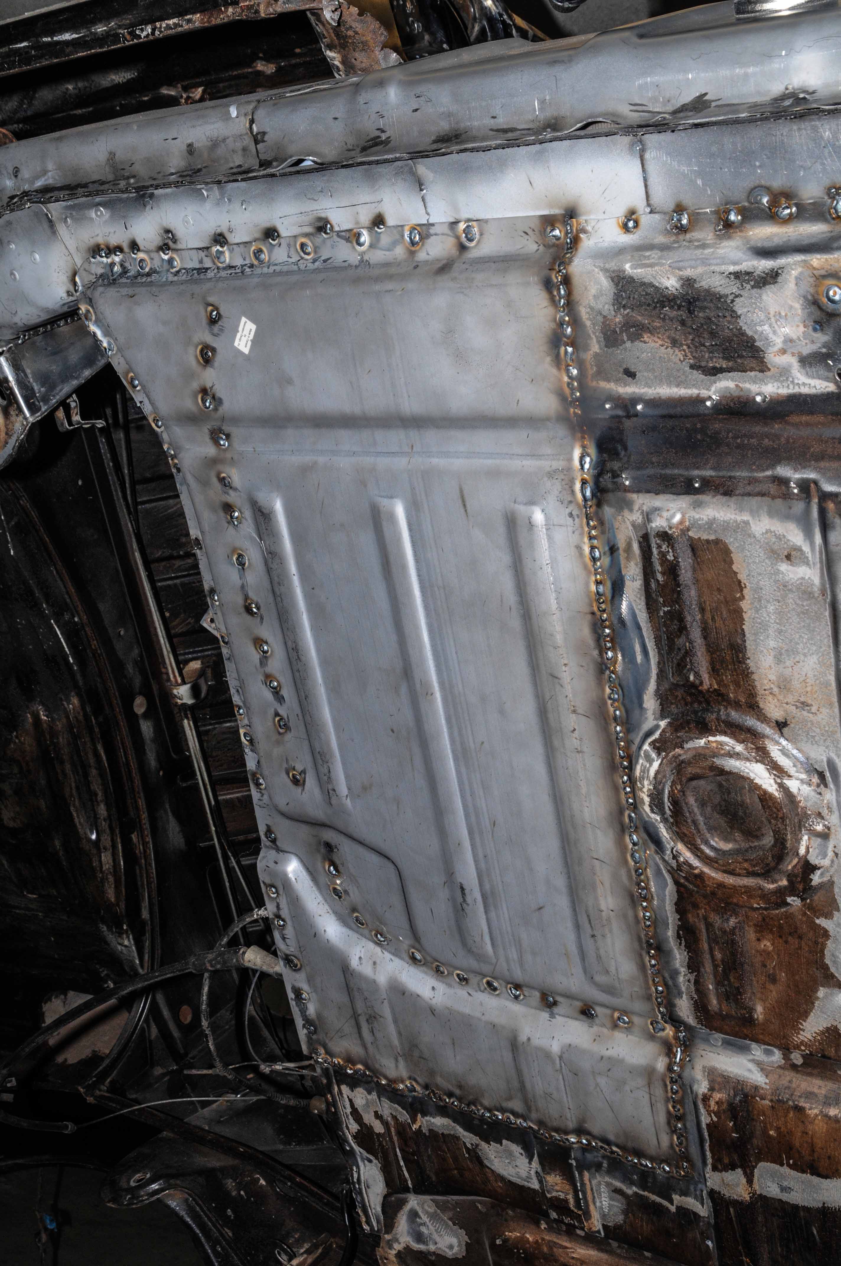

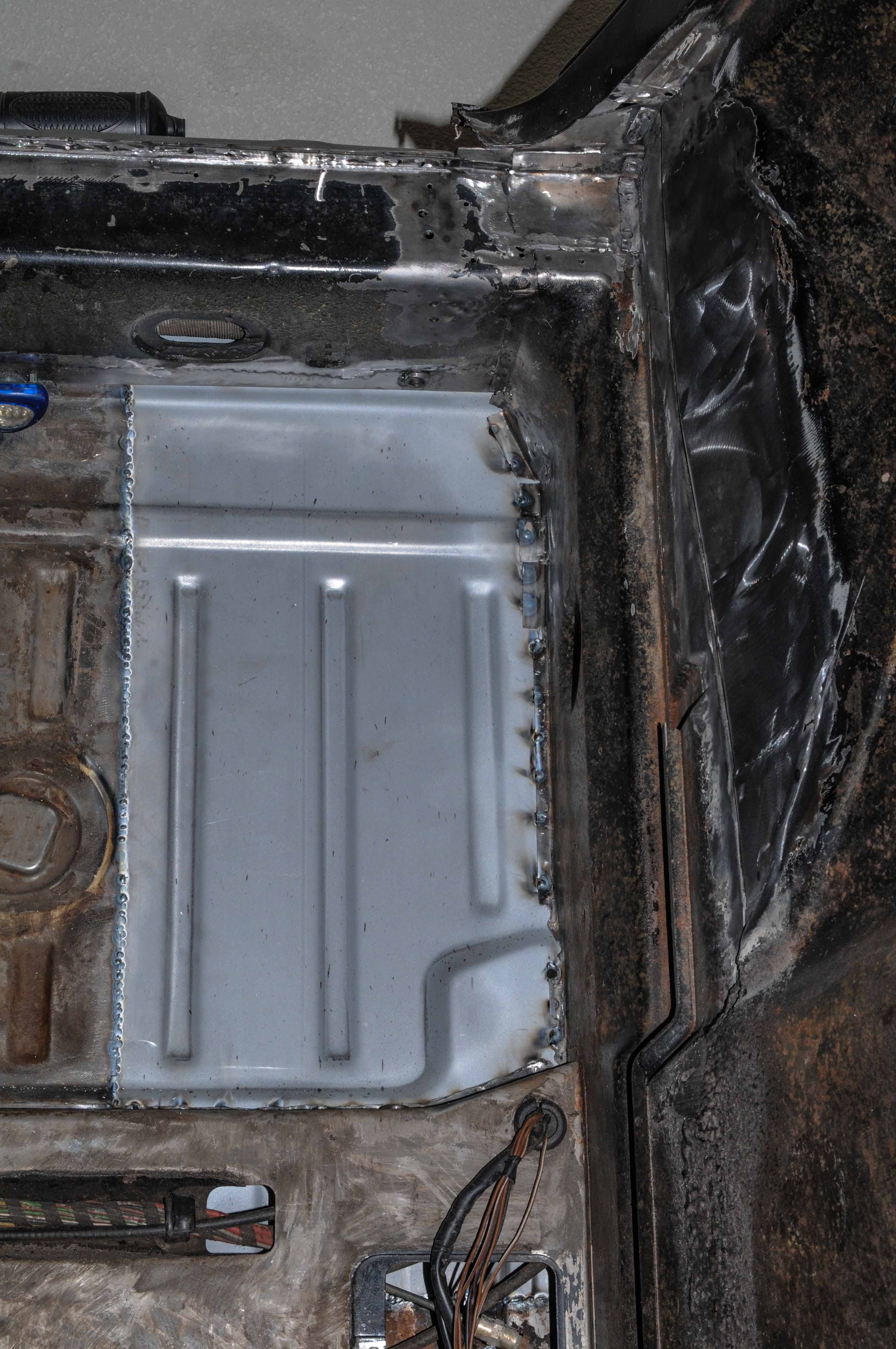

But the big event of the weekend was getting the floor section welded in. I had it fit and ready to go from last weekend, so it was just a matter of lining it all up, getting the edges even, etc. The big task was at the corner where the triangle will go; it stuck up a few mms and almost a cm at the corner. However, starting the plug welds at the other end I found I could hit the next hole's area a couple times with the hammer and it would go down flush all the way down the line. For some reason I threw a couple extra welds at the edge...and wish I didn't..they're extra ugly.

DirtyCossack   This weekend's goal was to tack the floor sect...   Feb 28 2016, 07:58 PM
DirtyCossack   But the big event of the weekend was getting the f...   Feb 28 2016, 08:02 PM
