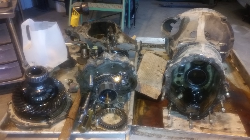

Back to work ...............
Super In Law got the extra tail shifter all broke down. Guts are going into a tote.
Case will be cut down for an engine test stand at a later date.
Thems are some shiny parts..............
