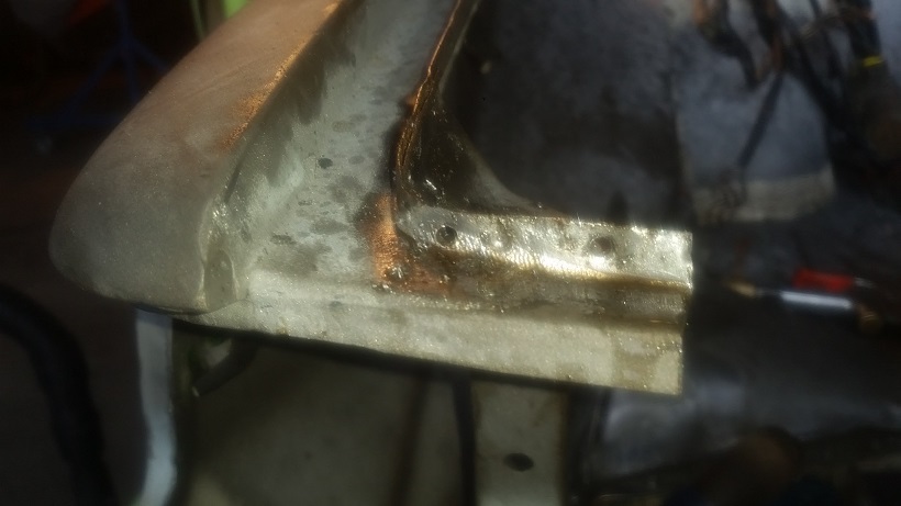

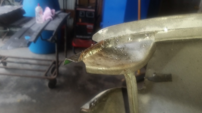

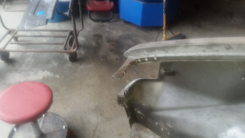

Now on to those pesky qtr.panel / rear panel corner pieces. Don't know exactly how I'll install/replace the rear panel to get the best fit & finish so I'll be careful with the corners.
Drilled thru the spot welds with a 5/64 bit. Maybe 3/16 would have been better. Split the seam using the small thin wood chisel.
After the spot welds were drilled out I needed to remove the tacks in the corner. Ground off the top one, which you can see. Drilled a hole thru the bottom one, which you'd see looking from the bottom. It attaches the corner to the brace.
All done .............
