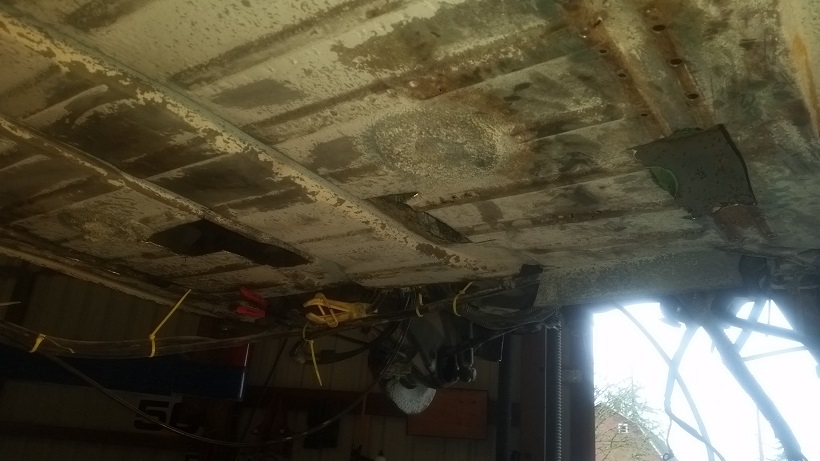

I've been asked by Mark to do some sheet metal/body work on his 75 2.0 Liter project car. The car arrived last Monday. But I needed to finish up a couple things on my project car and in my shop first. But I dove in this afternoon.
First task is to tidy things up after the paint stripping. Which included dropping the engine in order remove any residual media in the nooks and crannies. I was concerned with the rust prevention product that Dustless Blaster mixes with the glass media being left on and in the electrical connections. I'm a firm believer of an ounce of prevention is worth a pound of cure. I dribbled some OSPHO on a couple connectors in my white car. Not good. It ate the crap out the plating.

Observations :
Suspension Consoles look great and seem to be virgin.
Same with the motor mounts
Battery tray was changed at some time in its life
Back engine tray is bent to hell .............pushed up
Hell hole is filled with caked in blast media. Stopping at Sears on the way home for a new filter for my vacuum. I'll look closely for prior repairs.
Both the lower longs look great at first glance
Needing more research :
A few rust pits on the upper right outer wheelhouse long
But we also a have fairly good sized rust spot a little further up the upper long. Right next to the suspension console.
These are both in the double walled section of the upper long.

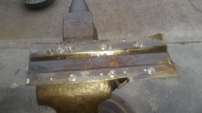

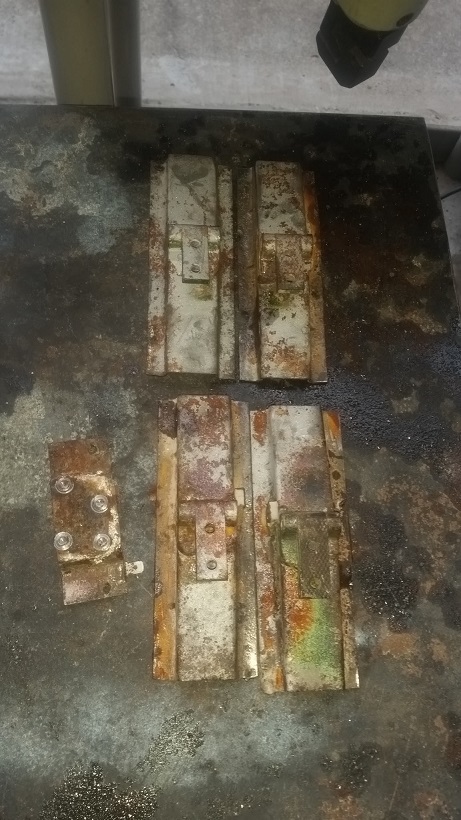

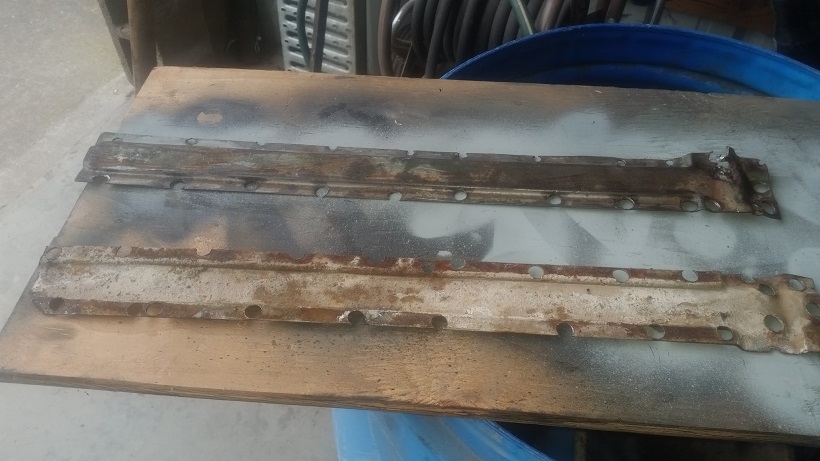

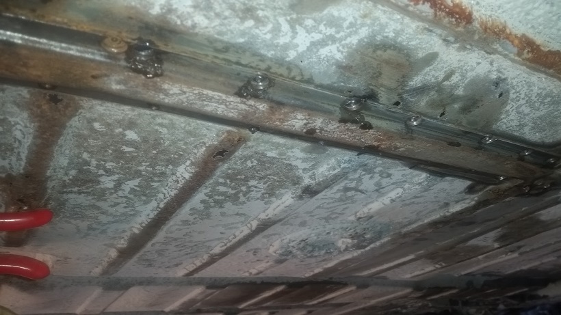

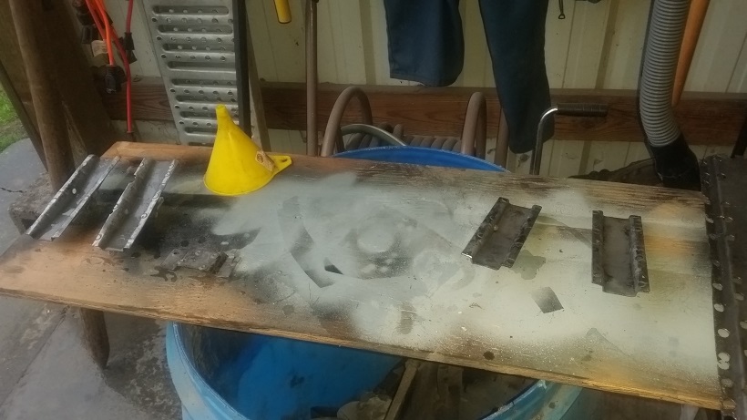

Next, removing the seat hardware from the floor pan.

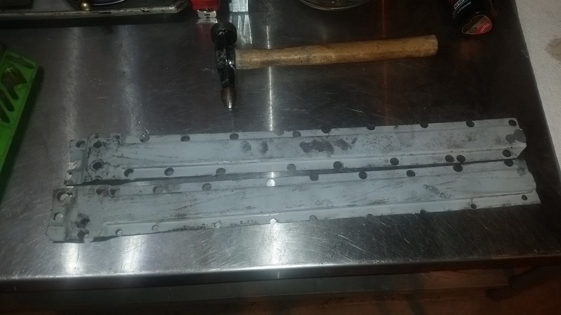

I start with the seat reinforcements on the bottom. I'm going to cut out the hinges with the cutting wheel so I can work on them in a vice.
After a run thru the blaster. I'll refill the holes and repunch smaller ones for the reinstall.
Out came the seat brackets and hinges .............. 4 1/2" cutting wheel from the top.
Much easier working on them in the vise.
After a trip thru the blaster. Sitting over night with an application of OSPHO. One hinge needs a couple new welds.

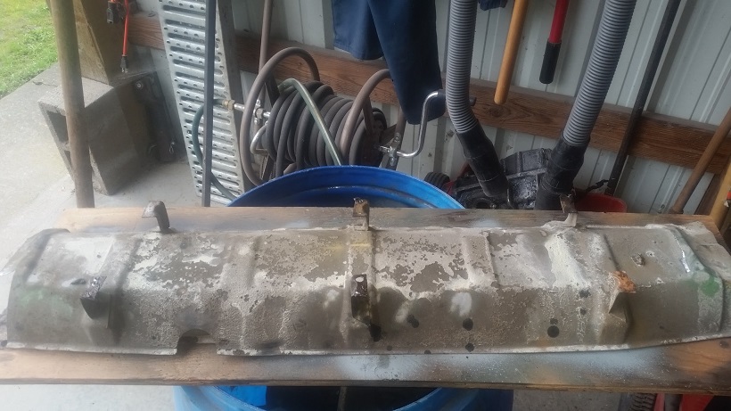

Removed the original trunk cut out from the heat shield. Spot welds were a little tough to find with all the metal degradation.

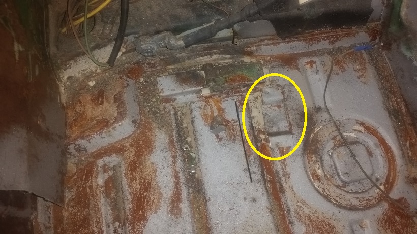

Reference Photo : Location on ground under right seat.
