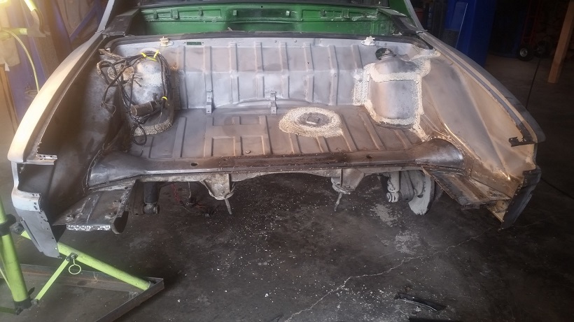

I've been asked by Mark to do some sheet metal/body work on his 75 2.0 Liter project car. The car arrived last Monday. But I needed to finish up a couple things on my project car and in my shop first. But I dove in this afternoon.
First task is to tidy things up after the paint stripping. Which included dropping the engine in order remove any residual media in the nooks and crannies. I was concerned with the rust prevention product that Dustless Blaster mixes with the glass media being left on and in the electrical connections. I'm a firm believer of an ounce of prevention is worth a pound of cure. I dribbled some OSPHO on a couple connectors in my white car. Not good. It ate the crap out the plating.
Here's Super In Law working on loosening up the media in order to blow it off. It will need to be steam cleaned.

Observations :
Suspension Consoles look great and seem to be virgin.
Same with the motor mounts
Battery tray was changed at some time in its life
Back engine tray is bent to hell .............pushed up
Hell hole is filled with caked in blast media. Stopping at Sears on the way home for a new filter for my vacuum. I'll look closely for prior repairs.
Both the lower longs look great at first glance

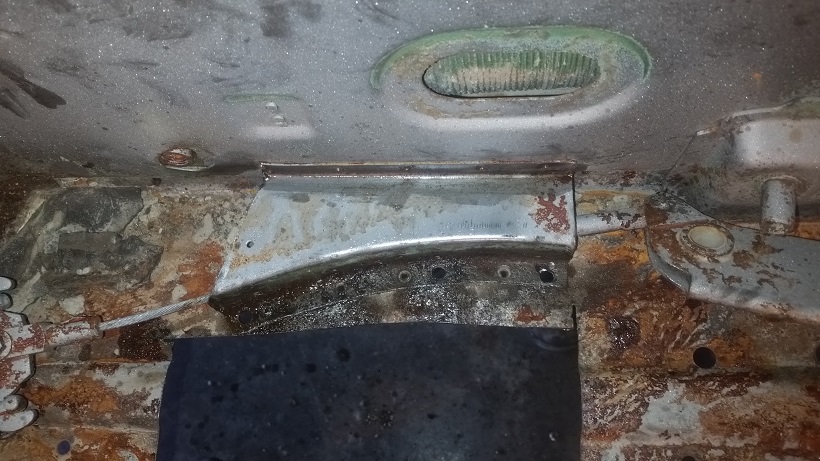

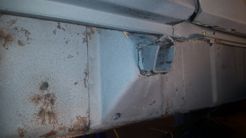

Needing more research :
A few rust pits on the upper right outer wheelhouse long
But we also a have fairly good sized rust spot a little further up the upper long. Right next to the suspension console.
These are both in the double walled section of the upper long.

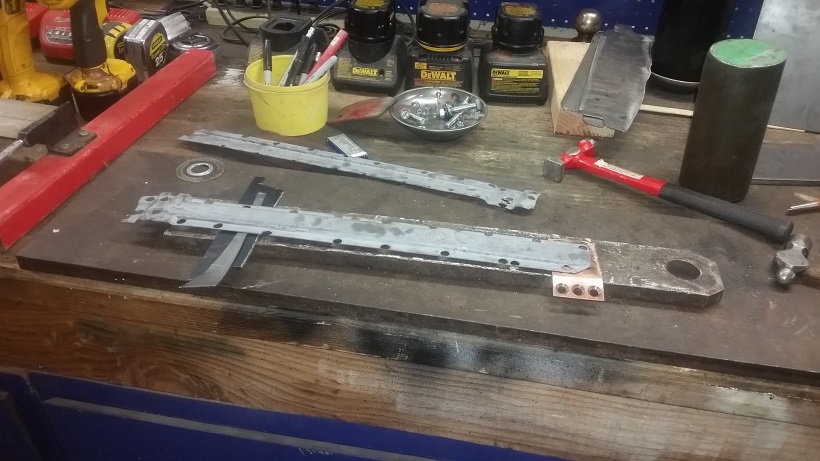

Forgot to remove the e-brake cable guide.
Super In Law (Jack) worked on filling the spot weld cutter holes in the seat reinforcements.
Back end all tidied up and waiting for parts.
Next on to fixing the right jack post. Looks like it's a virgin too, top is still welded.
