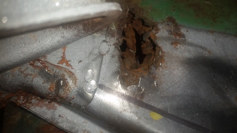

Needing more research :
A few rust pits on the upper right outer wheelhouse long
But we also a have fairly good sized rust spot a little further up the upper long. Right next to the suspension console.
These are both in the double walled section of the upper long.

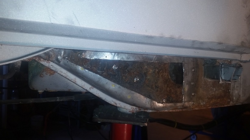

Fun just came to a screeching halt ............... (IMG:style_emoticons/default/barf.gif)
What you can't see is the HUGE mouse nest inside the wheelhouse ...............
This probably the best example I've ever seen of these cars rusting from the inside out.
These kind of took the wind out of my sails. Time for dinner and a beer.
Oh yeah .............. it's a shame someone buggered up the jack post. The metal under the jack post cover is just surface rust.
