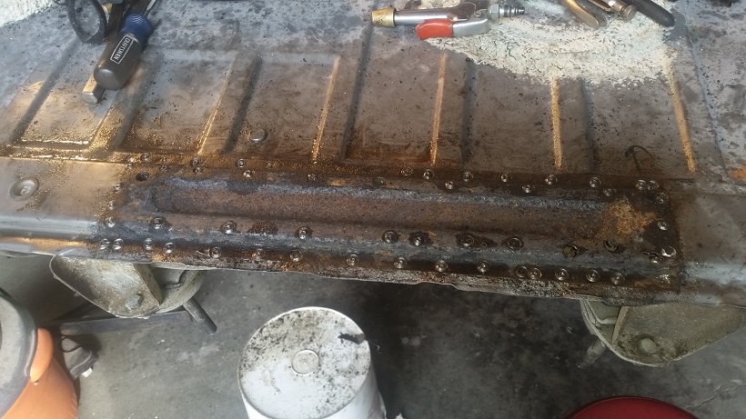

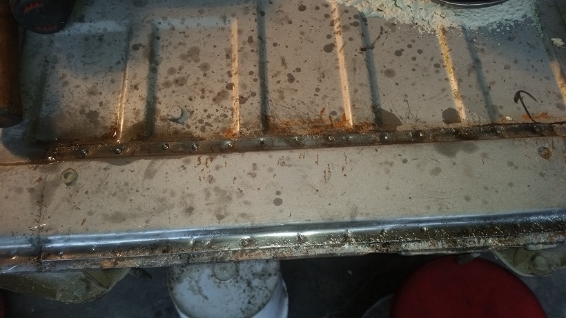

Now on to the task at hand ............ continuing with the rear trunk removal.
I start the day with removing the rear trunk reinforcement.
http://www.restoration-design.com/store/product/PP335A

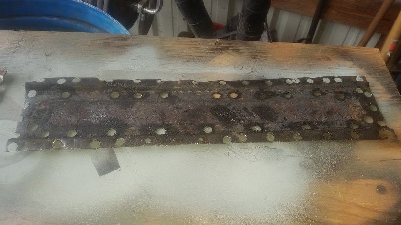

I was thinking we'd be able to reuse that part. Look at how nice and shiny it is on the topside.
After removal. Not So Much ............... for $25 it's not worth the risk. Even with OSPHO and POR15, not worth the chance.

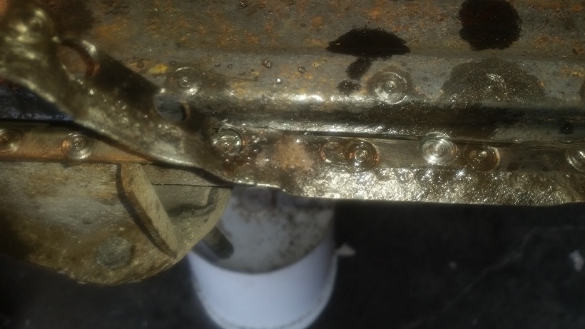

After removing that part I decided that we'll move to plan B and replace the entire trunk piece. Lesson Learned : Remove plate 1st to do your assessment. No time lost, because of the 75-76 bumper support I'd remove it the same way, in pieces.
Removing the remaining material off the back of the transmission support was pretty simple. I once again rolled it like a tin can. What I did learn. The floor pan is only spot welded in a couple spots UNDER the reinforcement. Then the top spot welds go thru all three pieces. So you just roll the material until you hit the next spot weld. Then give the already drilled out spot weld a just a little and roll on to the next one.
Tomorrow (today) I'll finish the right bumper support area. Probably no new pictures unless something exciting happens. I'll not cut out the remaining portion over the transmission support until I have the new part in my hand.
