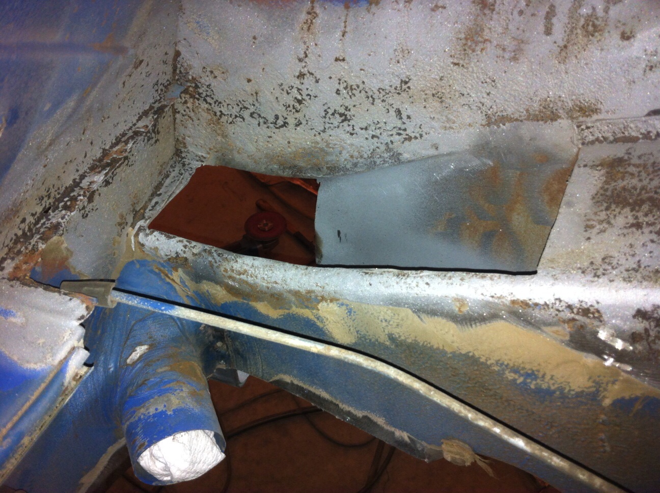

A few rust pits on the upper right outer wheelhouse long
But we also a have fairly good sized rust spot a little further up the upper long. Right next to the suspension console.
These are both in the double walled section of the upper long.

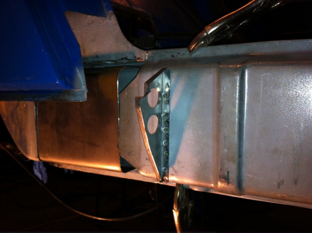

After a good nights sleep its time to go into rust attack mode. (IMG:style_emoticons/default/mad.gif)
I was hoping to only have to cut the door jam to remove and replace the jack point like Rick does. But think I'll need to remove the lower portion of the fender to get up into the wheelhouse. (IMG:style_emoticons/default/sad.gif)
But here's where I'll start this am. Originally I was only going to cut back the top rail about an inch and half and replace the flange. Now we'll open it up to survey the damage. And remove the mouse nest.
The battery tray will have to be removed first. But that was already planned with the flange/seam repair.
It got some 914World inspiration this morning after reading up on Rick's work on Vintage914Racer's car. I was about to say the the rust on Mark's car isn't quite that extensive. It just goes the other direction up into the wheelhouse. But I'll refrain from that proclamation for a couple hours.
