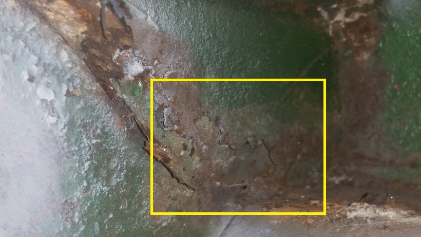

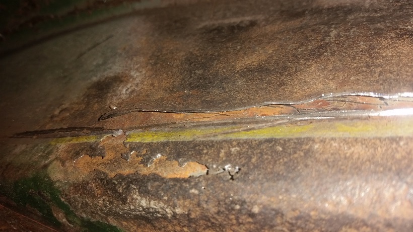

A few rust pits on the upper right outer wheelhouse long
But we also a have fairly good sized rust spot a little further up the upper long. Right next to the suspension console.
These are both in the double walled section of the upper long.

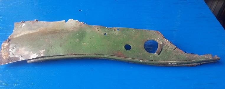

Battery tray and its support hit the floor first. Because it was seam welded it came out in pieces. (IMG:style_emoticons/default/sawzall-smiley.gif)
Next came the engine shelf. Needs to come out to open up the top rail. It's reusable.

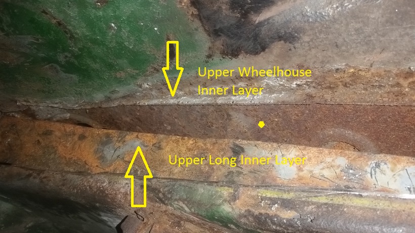

Once again a hillbilly double layered patch comes to light. That's the vertical firewall above the hell hole.
Now I peel off the top layer only on the top rail. Basically delicately cut a slot with the cut off wheel. Then peel it back with screwdriver and or small wood chisel.

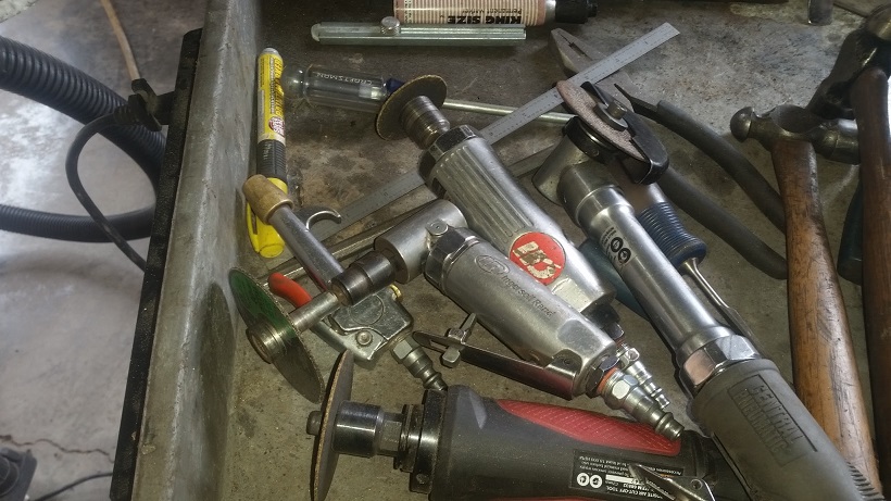

As I hit spot welds I cut them down from the top side with the mandrel mounted cutting wheel.
Arsenal of cutting wheels ................

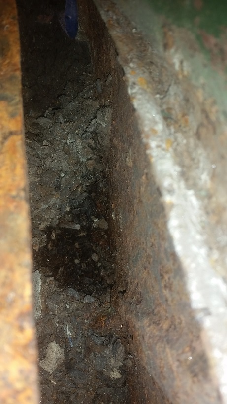

Here's a top side view of what remains of the mouse nest.

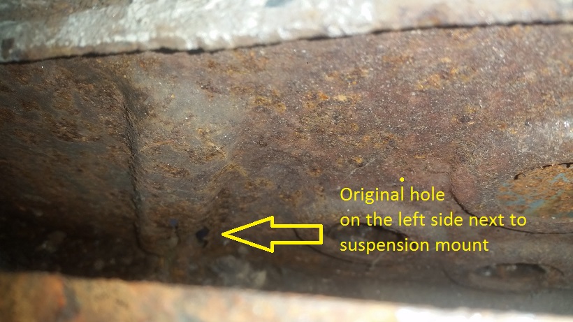

Inside shot of the original large hole I created with the screwdriver.
Mission Complete ................
