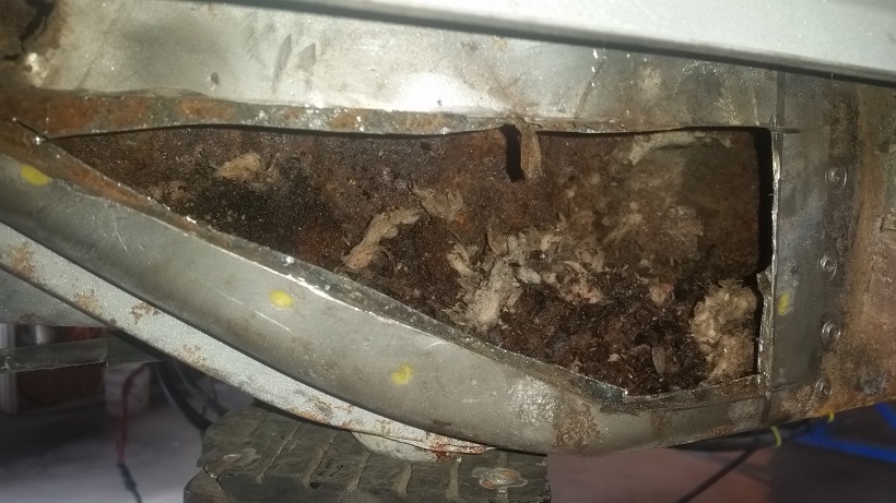

Opened up the wheelhouse so I could continue to vacuum out the mouse nest. Got most of it. But I'll need to dig deeper down the inner long.

mbseto   What you can't see is the HUGE mouse nest in...   Mar 2 2016, 04:09 PM

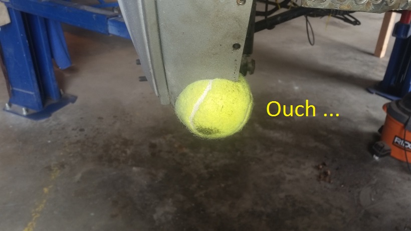

cary   Things that make you go Hmmmmmmmmmmm. Can I cut of...   Mar 2 2016, 10:18 PM
