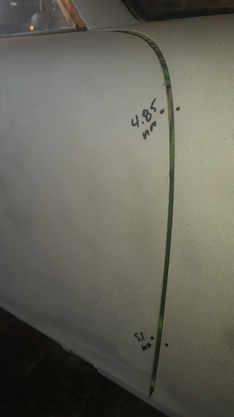

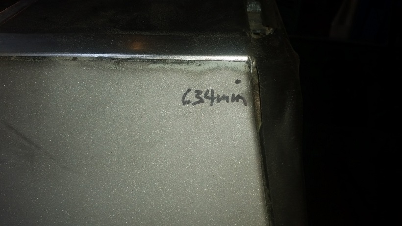

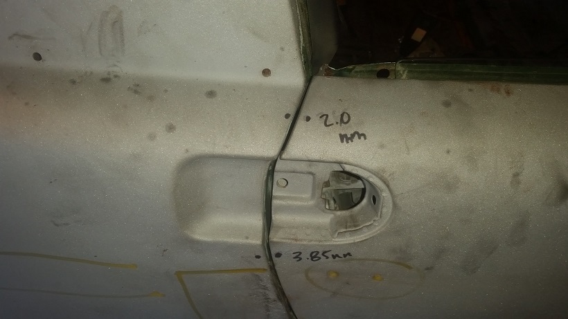

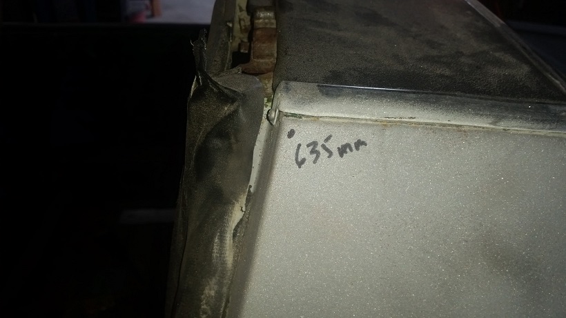

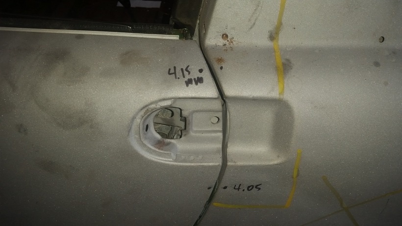

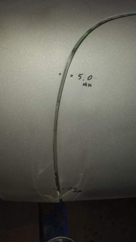

I make multiple measurements before I remove the doors for the door brace install.
