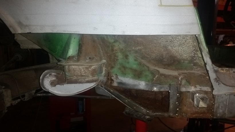

A few rust pits on the upper right outer wheelhouse long
But we also a have fairly good sized rust spot a little further up the upper long. Right next to the suspension console.
These are both in the double walled section of the upper long.

Beings that I'll be doing some work to the wheelhouse, off comes the fender. I know Rick is shaking his head. But I need room for my tools and lots of light.

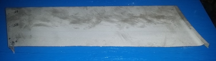

cary   Now's it time to create a 75-76 rear panel fro...   Mar 7 2016, 10:39 PM

cary   Finally finished up creating the 75-76 rear panel ...   Mar 15 2016, 10:42 PM

cary   [b]Modifying RD PP335 to replicate the 75-76 rear ...   Mar 18 2016, 07:19 PM
