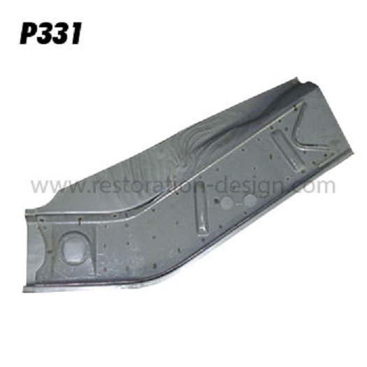

Things that make you go Hmmmmmmmmmmm.
Can I cut off the front and slide the inner layer behind the outer suspension mount ?
If could figure it out. How would I clamp/press the new inner layer tight so I could weld it.
Looks like RD might not be selling the wrinkled AA piece anymore ?
Or the RD guys decided to shear off the crappy part.
http://www.autoatlanta.com/Porsche-Lower-A...450194420C.html
