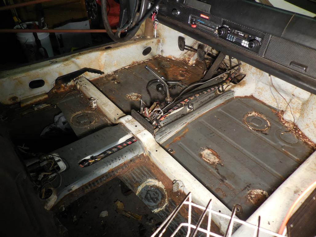

I have gotten around to removing more cancerous rust and also have finished scraping off all of the rubber that was stuck to the bottom floor pans and i was pleasantly surprised with the quality of metal underneath.
(IMG:http://www.914world.com/bbs2/uploads_offsite/imgur.com-19149-1456980804.3.jpg)

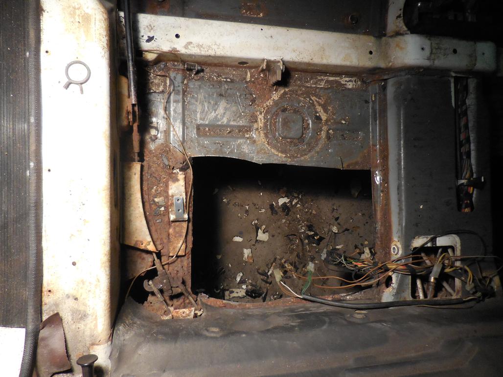

I did find a few bad more rust spots that i wasn't really expecting next to the ebrake handle so now i will have to remove that as well.
(IMG:http://www.914world.com/bbs2/uploads_offsite/imgur.com-19149-1456980804.4.jpg)

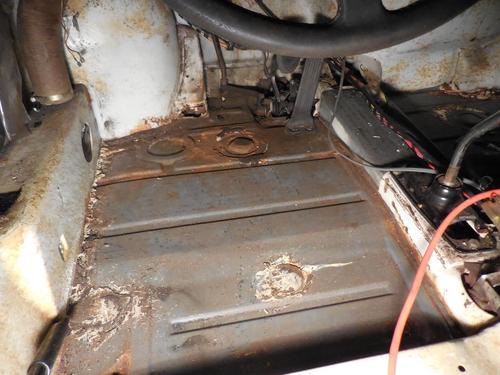

There is some rust near the front and im not exactly positive how to address it. I can cut it out pretty easily but i dont think id be able to reweld a panel in very well so we will see.
(IMG:http://www.914world.com/bbs2/uploads_offsite/imgur.com-19149-1456980805.5.jpg)
Good news is that i have been practicing my welding and have gotten proficient enough to weld up two bikes.

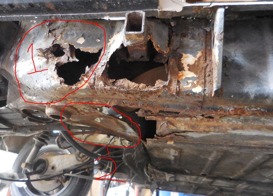

Questions:
Alright need some help here, what parts do i purchase for this 1 and 2?

DirtyCossack   #1 is the Inner Wheelhouse Restoration Design part...   Mar 3 2016, 07:44 PM
brettrarnold   Thank you Dirty Cossack for the help. Parts are o...   Mar 7 2016, 10:45 PM
