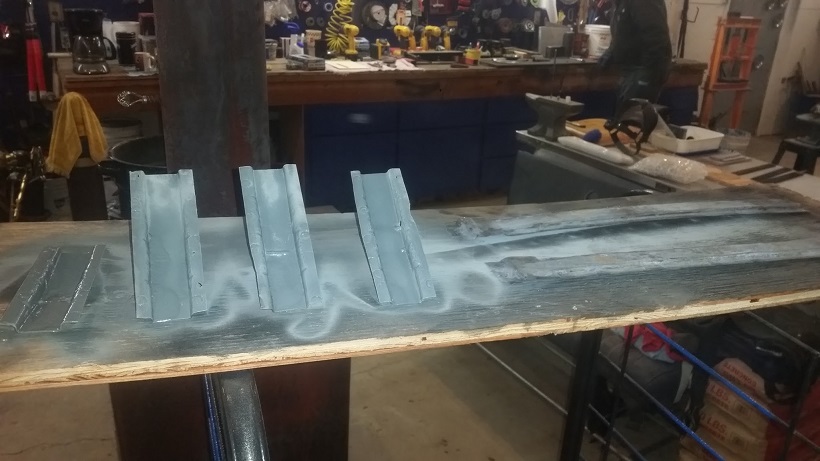

Start the day with primering the refurbished pieces that were OSPHOed overnight.
After that I'm back to the wheelhouse.

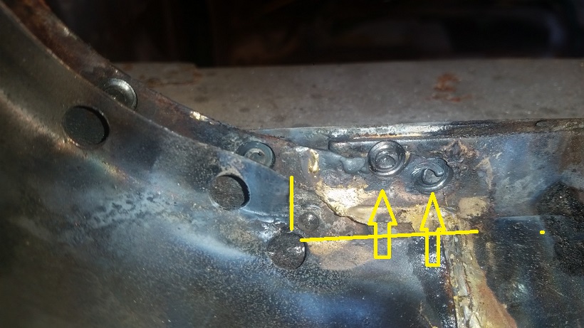

Step #1, remove a portion of the door jam. Thick line is were I cut. Probably should have gone up a bit more. Couldn't get the spot weld drill in the right place to drill out the top of the jack point.
This shot is after the jam is detached. The yellow arrows are spot welds that don't need to be drilled out. The lines are where the brazing comes loose.

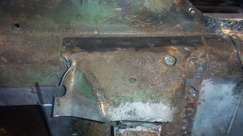

Here's a couple shots of the top of the jack point. 6 spot welds. The bent corners is my fibile attempt to pop off the jack point with a chisel yesterday. (IMG:style_emoticons/default/headbang.gif)
Words of wisdom : A chisel is not something that you want use too much around 18 gauge metal, only directly on welds.
So I used the Rick grind and pop method to get the jack point off

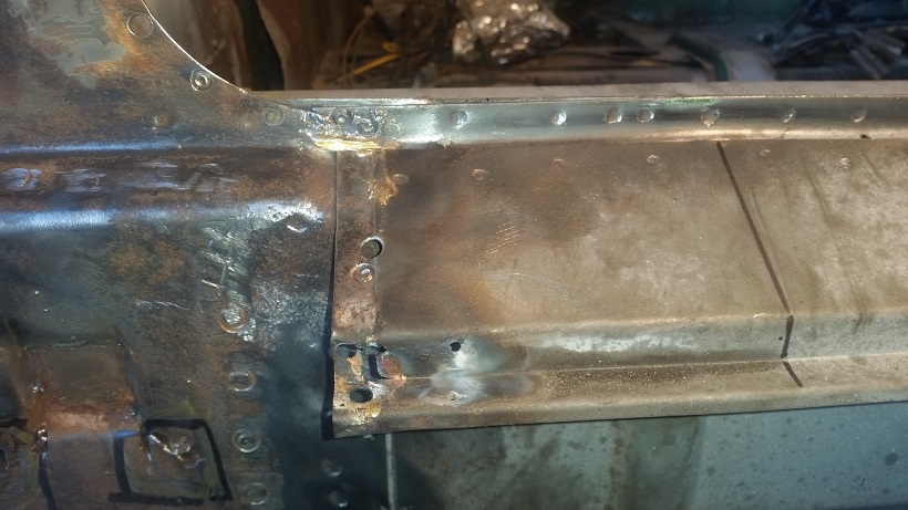

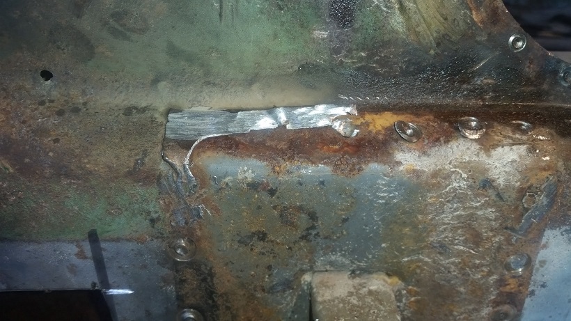

Step #3

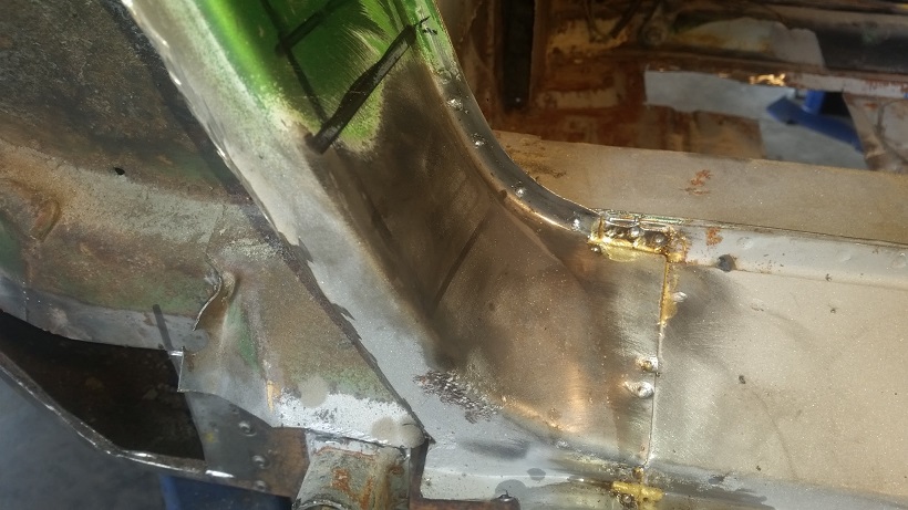

Remove a portion of the sill so the wheelhouse to long joint can be drilled out.
That corner will be sent to the Super In Law refurbish workbench. Brazed over the top of a spot weld.
