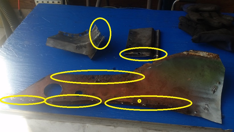

Today's items sent to the refurbish workbench.
Yellows circles are areas that will be refurbished.

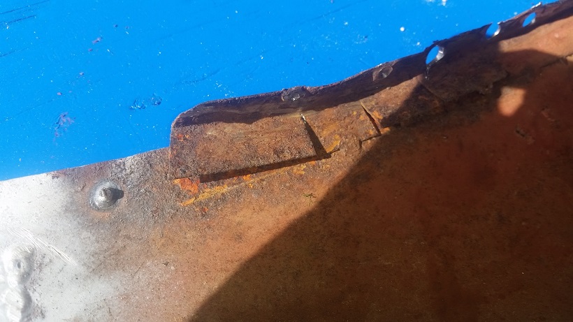

This is the bottom of the right engine shelf. The rusted portion is the flange that the molding channel gets welded to. I missed the bottom on my parts review before I sent the parts list to Mark. I caught taking off the molding channel. Oh well, saved Mark $180. We 'll cut and patch the shitty part. And recreate the flange. With Super In Laws high wage ($0) it will work out. If it was a regular shop deal. Recycle bin item.
