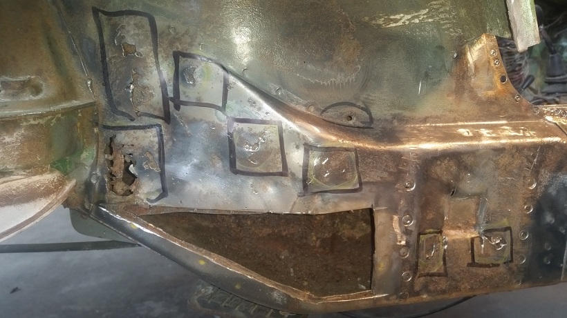

Here's a better shot of the wheelhouse with the fender and door jam removed. Lined out areas are rusted thru.

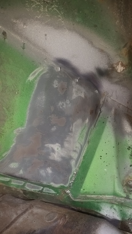

It' a shame this happened. Here's a shot of the wheel house above the suspension mount. Virgin. I still contend this was caused by the seam sealer on the top rail being removed and not replaced. (IMG:style_emoticons/default/mad.gif)
I'd still like to try sliding the inner layer behind the suspension mount. It would be some tricking welding. Might have to buy some special arc welding rod to tack it in. Would have to build some turnbuckle gadgets to push it up tight so it could be welded. But I like a challenge. That's how I roll.
But the anal part of my brain says the weld will be too close and too big next to the suspension mount. So the mount and its dreaded tie will have to be removed so it can be patched correctly. (IMG:style_emoticons/default/sad.gif) Plus it we give a better view of the condition of the upper inner long.
This will entail building a fixture for aligning the mount when we reinstall it.
This as far as we go without having the new part in my hand for measurements ................
